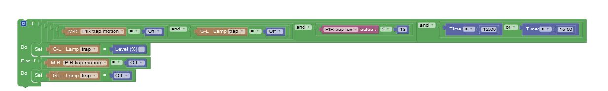

I have a blockly script (see image)
- script.JPG (45.49 KiB) Viewed 1356 times
for my stairway (1 motion sensor and 1 fibaro switch).
When the event is active I would like to override the event by pressing the physical button so the light stays on even when there is no motion detected. And when I turn off the lamp by pressing the physical button it will activate the script again.

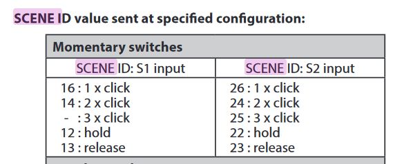

I have activated scene, so I have set a scene with double click and triple click. But I think did doesn't involved the blockly event.

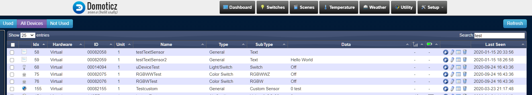

Can you please share these devices as shown on the devices tab [setup][devices]
like this example
- devices.png (112.66 KiB) Viewed 1225 times

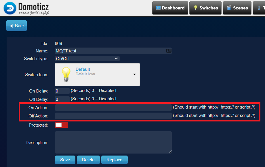

and (if any) the On / Off actions of the switches [switches][edit button on the switch]
like this example
- On,Off.png (55.75 KiB) Viewed 1225 times

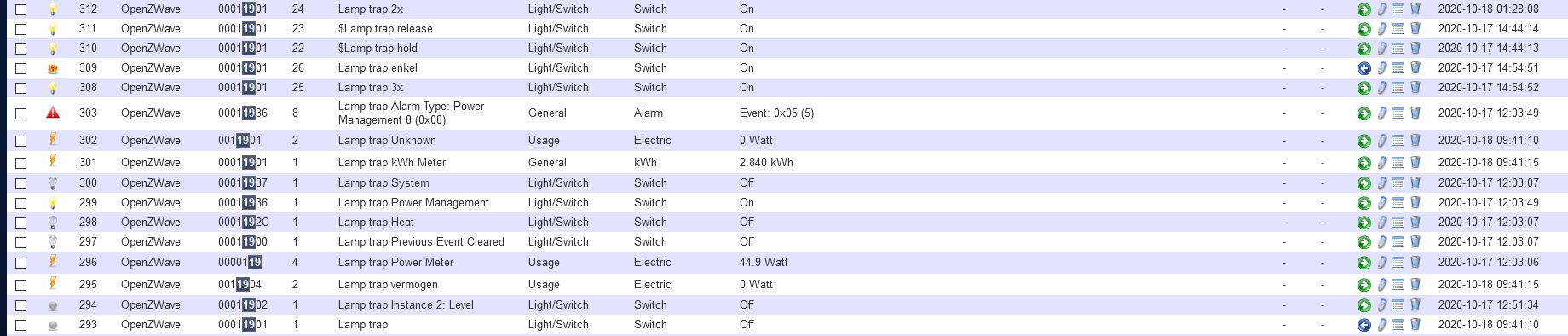

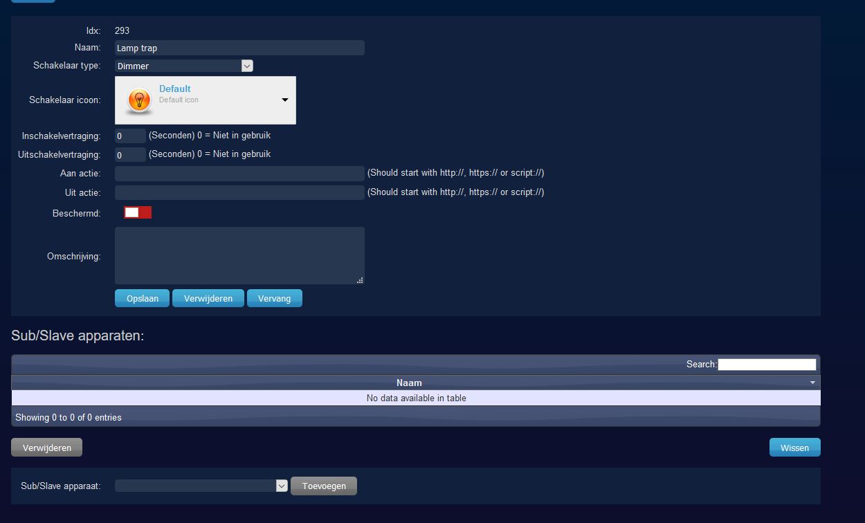

by Cndiann
See below.
ID 22 till 26 are extra because I have activated scene option.
I use Lamp trap (id1, idx 293) for the blockly script.
- lamp trap.JPG (72.69 KiB) Viewed 1219 times
- device trap.JPG (140.67 KiB) Viewed 1219 times

I have a motion sensor in the hallway and a FGD212 Dimmer 2. I connected 2 physical momentary switches on it. So If I press once the light 'Lamp trap' goes on.
In blocky I had this event:
- blockly.JPG (32.42 KiB) Viewed 1135 times
It does the job but when I switch the light with the physical switch it trigger the blockly event so the 'Lamp trap' goes out when the motion detector is off even If I do this at 10:00.
And I didn't get manual override to work, so I can switch the physical switch for example on 10:00 and 'Lamp trap' stay on even if there is no motion detected.
