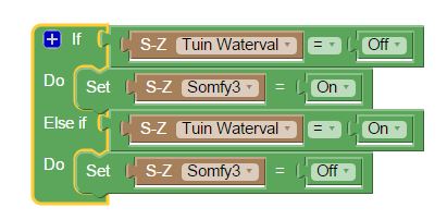

i've made the next workaround to make the powerplugs work for me:
-created a dummy switch ("Tuin Waterval").
-created a real switch ("Somfy2"), the actual powerplug.
-created the next blocky:
When I turn the dummy switch "on" then "Tuin Waterval" is "on" (but the real powerplug is in domoticz "off").

kroonsteen
- Posts: 4
- Joined: Sunday 19 April 2015 20:54
- Target OS: Windows
Re: RFY (somfy) relay device -> on/off inverted
