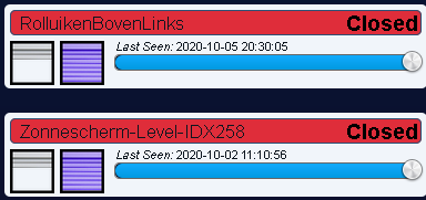

It seems my Zwave devices are horibly broken, so I cannot use my shutters, screens and door/window contacts anymore :(. Please help.
This is not the first time all the zwave devices are out of function, but last two times I just stoped domoticz, removed the domoticz directory and put back a backup. This doesn't work anymore. I am running domoticz beta and I think its the OpenZwave tool / libs that break with updates. Unfortunaly, like I said, putting back a backup doesn't help it back to running. This is what I run now: Version: 2020.2 (build 12451)
The Zwave hardware, as lsusb tells me: Bus 001 Device 006: ID 0658:0200 Sigma Designs, Inc. Aeotec Z-Stick Gen5 (ZW090) - UZB
The devices are red:

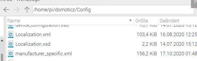

today i get the same error.
The file manufacturer_specific.xml was renamed to manufacturer_specific.xml.2.
I stoped domoticz renamed the file and start domoticz again.
vodor
Posts: 39
Joined: Friday 19 February 2016 14:47
Re: OpenZwave broken, devices malfunction
Post by vodor »
Thanks same issue for me today. Seems the latest manufacturer_specific.xml is causing the issue. I copied manufacturer_specific.xml.2 back into manufacturer_specific.xml and now zwave devices works again.
