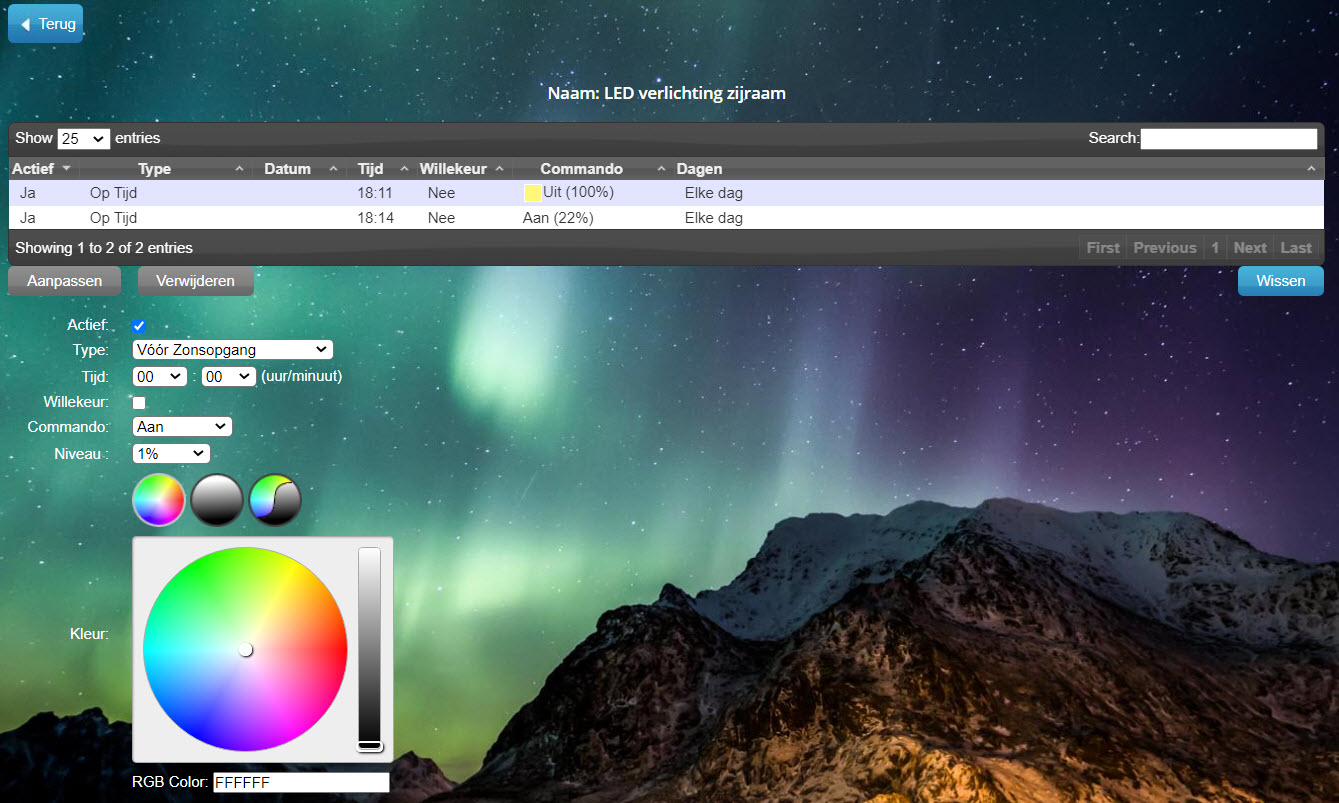

Dear Domoticz users,
I have a short question...
I use the Magic Home Led controller. When I manually switch on/off the lights (i.e. devices panel) everything works fine :-)
But when I use the timer option, nothing happens.
Can someone tell me what I am doing wrong (please see the enclosed files)?
