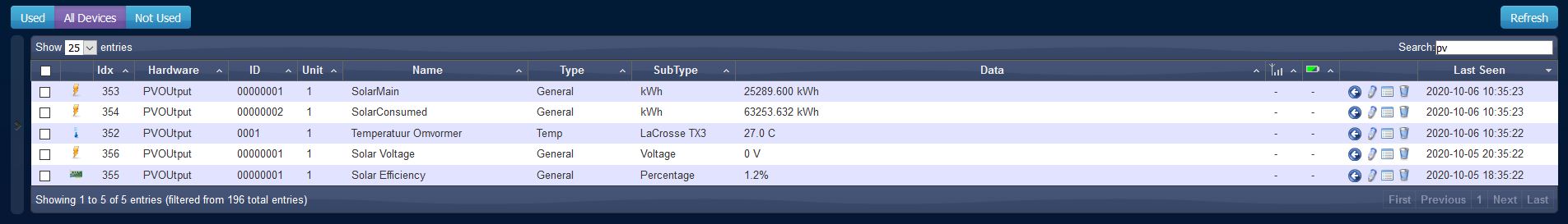

I see the HardwareType is 'PVOutput (Input)'
A specific blocktype is defined for this kind of hardware, but I see in the code that the assumption is that it's an energy device, not a temperature.
Do you also use other PVOutput devices?

Can you post the Domoticz json output of all your PVOutput devices?

Hi Lokonli,
Thanks for your help. After the update the PVOutput temp block works fine and also the other PVOutput blocks were displayed.
For your information I added a jpg with the PVOutput devices.
So I think this is solved!
