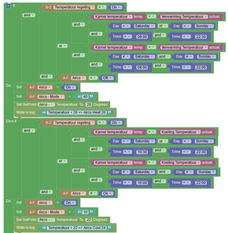

I am trying to setup a basic blocky to control our livingroom airco. I don't want the airco to be running when the house is on the desired temperature.
The problem I have now is that the airco does not start when it should. I do see the 'start an action' messages in de log.
As Airco - Mode I tries 'Heat' and 'Cool'. Last try was with the internal numbers. See attachment.

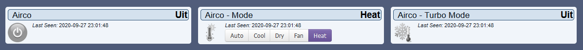

I can control the airco manually via the domoticz dashboard:

This is the blockly:

To me your blockly looks good.

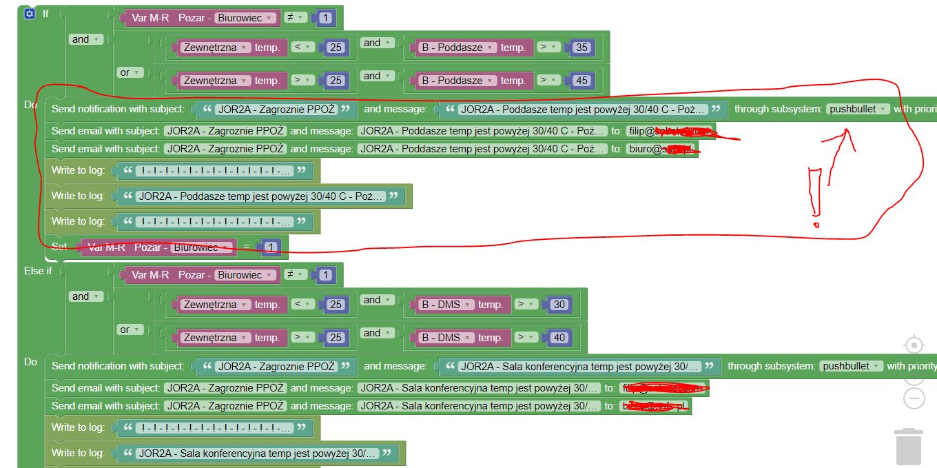

If I have such a problem that Blockly doesn't work for some unknown reason I add sending emails or notifications instead of writing a log.
This really helps debuging the reason:
