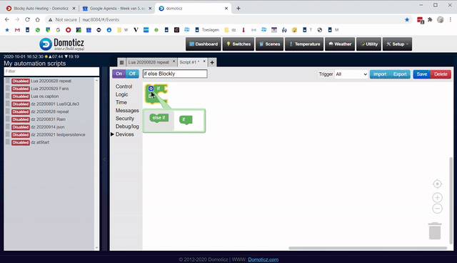

Larsoss wrote: Thursday 01 October 2020 15:17 However, it does not work .. The log also remains completely empty.
I guess you have to change the two "If Do" blocks into one "If Do Else If Do" block
( Click on the gear symbol and drag the else if under the if. Click again the gear symbol to clear this else if creation mode)
