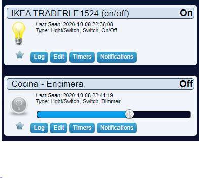

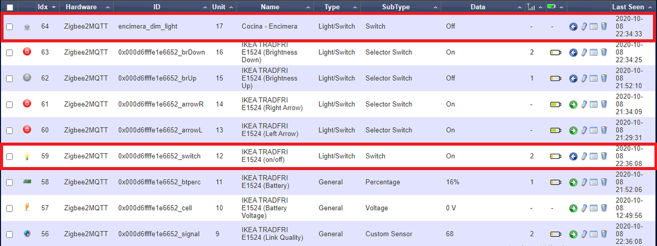

Sorry for a late reply but I wasn't able to try this before due to family problems (All solved).
I was able to configure the TRADFRI light but I have got couple of questions that maybe you could help me with it...
Firstly, I am not capable to switch the brightness up or down as the group has only created a device (device on/off). I have to add that the controller has also only created a switch once I added.
Then, I have added the controller to the group as a member (I think it is in the right place). The thing is that when I switch off the lights directly from the remote, the status does not change on domoticz. I don't know if I'm doing something wrong with this or if I have to create a script to change the status.
Thank you again. If you need anything or couldn't understand something please, let me know.

Not sure I fully understand. When you pair a lamp in Z2M, you still need to go to devices and add it there. It will be added as a device set to unused.
When you add a group, Z2M will create a "group device" so you can switch all the devices in that that group at the same time. You can also use a zigbee remote to control those devices.
In my case, I have a device (by itself) in a group and a remote controlling that group. Using the Ikea remote, I can switch the ikea light on off but also dim. I can also dim the ikea light itself.
The one thing you need to understand is that the Z2M plugin does not know what devices you include in a group. The guy who built the plugin therefore built the plugin such that you can define this using a suffix. So if you call your group something_ct then the plugin treats the devices as colour-temp devices and creates a specific group device to control them. That's all described under zigbee groups support at https://github.com/stas-demydiuk/domoti ... qtt-plugin
So it looks like you may still need to add individual devices in the domoticz devices list if they are not there yet. And, if the remote works, it should also dim lights that are dimmable.

Hi! I am such an idiot guy!heggink wrote: Thursday 08 October 2020 21:25 Not sure I fully understand. When you pair a lamp in Z2M, you still need to go to devices and add it there. It will be added as a device set to unused.
I hope that helps and answers your questions. If not, PM me with some screen shots of the devices and groups you have added.
Herman
ps: since about a week or so, there is a new version of zigbee2mqtt which a bunch of improvements. It's quite a lot better! I would recommend being on the latest stable version.
I didn't add the termination "_dimmer" at the end of the group. That was the issue...
I have everything added to domoticz and now it works perfectly.
Finally, do you know any way to update the status on domoticz when I use the remote or vice versa?
As you can see on the pictures below the devices does not update once i use either the remote nor domoticz.
The way I thought it is by doing a script but I do know how to do it if it is a dimmer.
Thank you again and I hope this helps somebody else in the future.

That's weird as Z2M should track updates and inform domoticz. Can't really tell why that is not happening. Have you tried looking at the Z2M logs when using the remote? At the same time, look at the domoticz logs as well.
