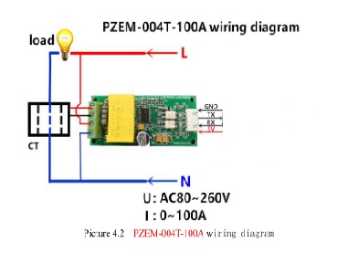

Thanks for the reply. But I have seen this sensor and it has a coil which has to be connected to a wire. So can we connect this coil to any load wire-like fan, Tubes, bulbs, etc? Also how many pzem-004T can be connected to one ESP? Can I connect 4 of them to a single ESP as I want to measure power across all the 4 switches? Any connection diagram from your side will be well appreciated. Thanks :D

I have a D1 mini connected to 4 PZEM-004T working perfectly (not with EspEasy but a private code)
Connection is very simple : connect PZEM with 4 cables : GND, +5V, TX, RX. Connect power to GND/+5V, ESP RX to PZEM TX and ESP TX to PZEM RX. You need first to connect only one PZEM at time, on order to load a unique address in its EEPROM. When all PZEM have different address, you may connect them altogether. Your code should send first address of PZEM to be read to select the right one.
On the "other" side, you should connect neutral and lead, plus the 2 wires from the coil. Only ne wire of the powered device (the one you want to measure consumption) should to through (inside) the coil. You can connect whatever you want (motor, bulb, neon...), as long as current is less than 100A, which should reasonably be the case.
Library is at https://github.com/olehs/PZEM004T
