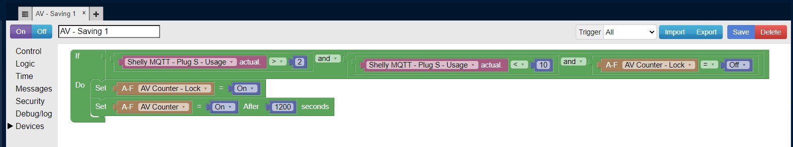

Step 1 is seeing that the usage is lower than 10Watt.
step 1 usage lower .jpg (75.94 KiB) Viewed 555 times

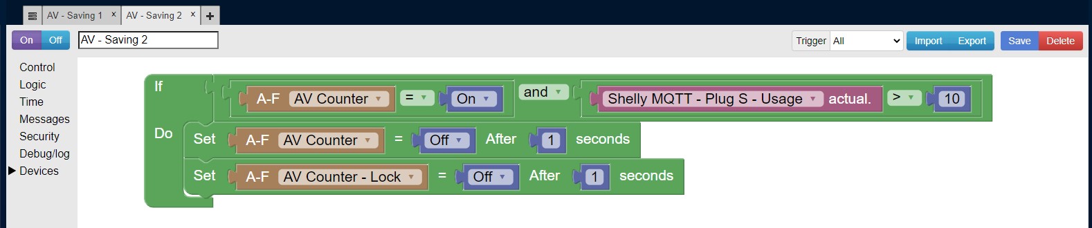

Step 2 seeing usage is again above 10 watt after 2100seconds (20 minutes) and cancel shutdown.

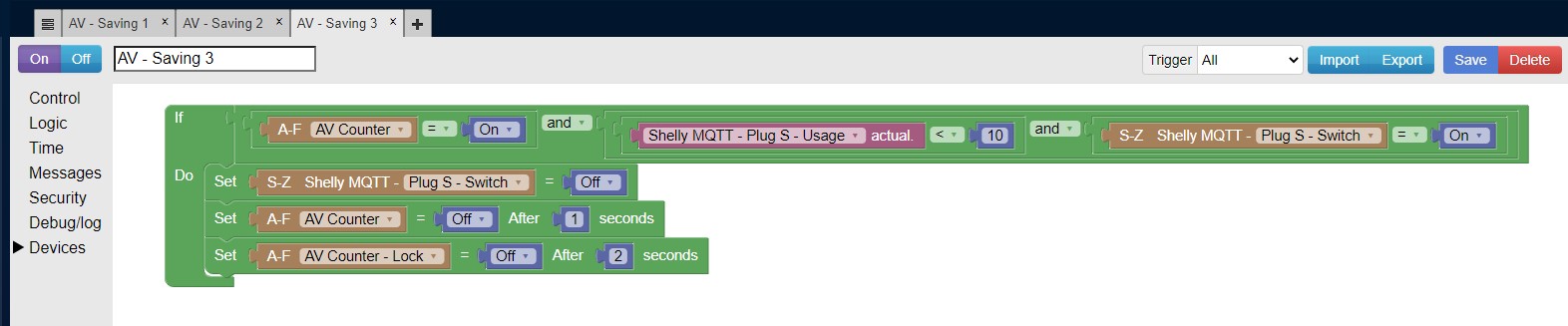

Step 3 is seeing usage still is lower than 10Watt after 20 minutes. and shutdown Shelly Plug S.
step 3 usage stays low.jpg (88.65 KiB) Viewed 555 times
but the Shelly Plug now gets randomly shutdown by Step 2 that doesn't even contain the Shelly Plug inside the event.
of by an not existing timer.
i hope to find a way to eliminate these strange errors.

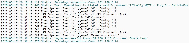

log and general log

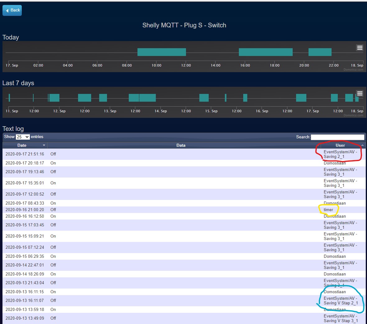

the Shelly Plug Log, in RED the latest random shutdown when usage was 200Watt+ in YELLOW a timer shutdown (i don't have timers set for this device) in BLUE random shutdown, after this one i deleted all events en created them again in case something went wrong behind the scene.
General log, it sees step 1 and 2. but at the time of shutdown 21:51:16 is sees nothing.
general log.jpg (63.06 KiB) Viewed 554 times

I see in the screenshots that you set the 3 Blockly scripts to trigger at 'All' , implying on every device update in the system and every minute. Is this as intended?
