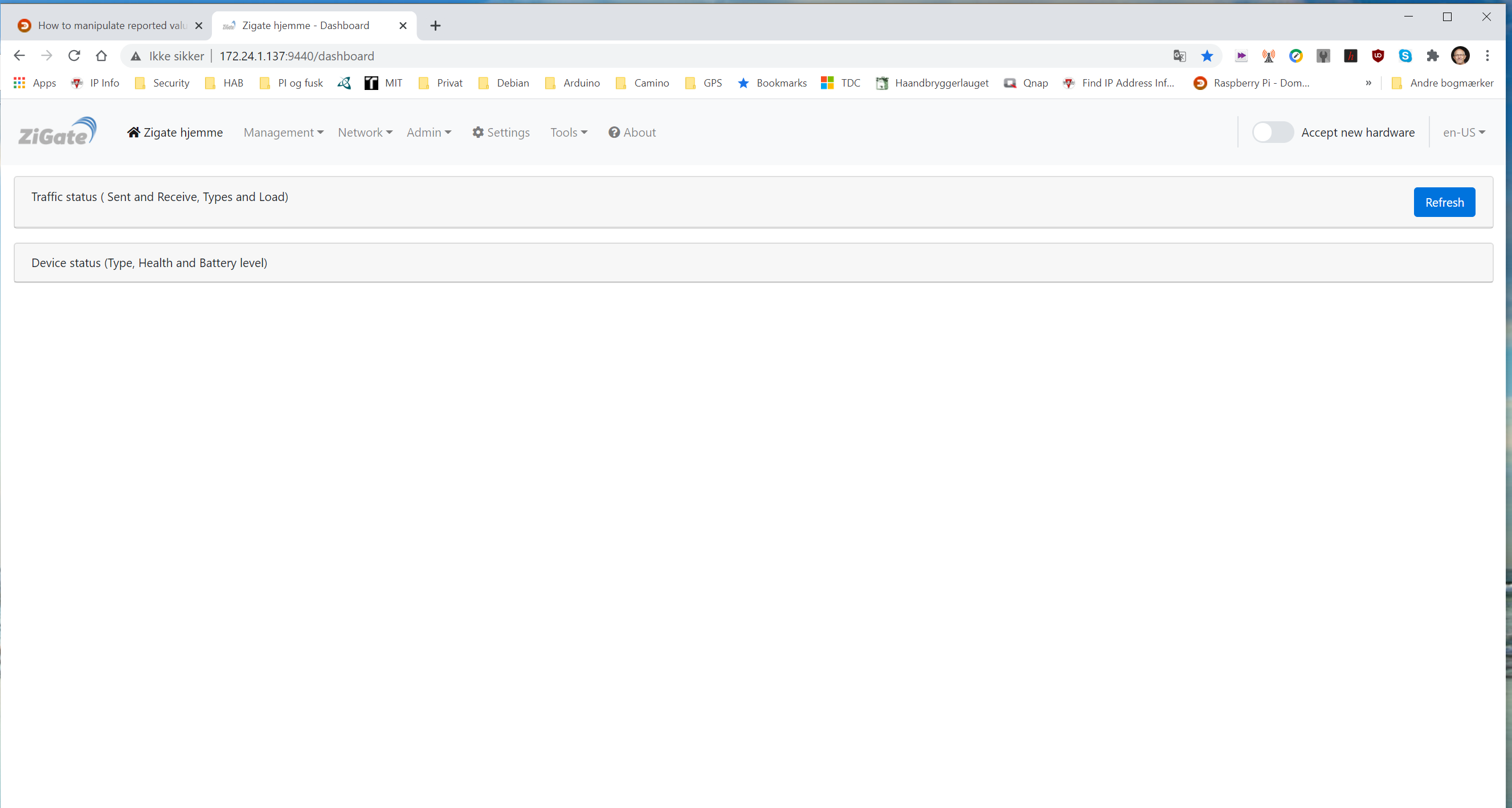

Attached is the Dashboard, no change if I hit the refresh
TKurt
zigate dashboard.PNG (160.66 KiB) Viewed 1720 times

For the dashboard, can you enable the Console mode from your browser (usally you need to press F12) and then select Console, do a Refresh and check if there is any errors ?
Could you try with an other browser ?

Sorry for the late answer, have tested Chrome and Edge, in Console window(tap) no errors - sorry.

Have discovered this: the "frontpage" has no errors in "Console mode", but when i enter Settings in the menu I get this:
Hope it's useful

pipiche
Posts: 2042
Re: How to manipulate reported values?
Post by pipiche »
Can you try to clear the cache ?
Kurtsejr
Posts: 24
Joined: Monday 04 December 2017 23:01
Location: Danmark
Post by Kurtsejr »
Sorry no impact, if I clear the cache
/Kurt
ben92
Posts: 57
Joined: Thursday 14 August 2014 17:41
Location: France
Post by ben92 »
HI,
Can u open the console when you are on the dashboard, hit Refresh buton.
Take a picture of the console tab and the network tab please.
on the network tab, you will see the data that passes between the plugin and your browser.
Check that the call to "plugin-stat" brings you data by clicking on the line and going to the preview tab.
On Chrome browser please.
