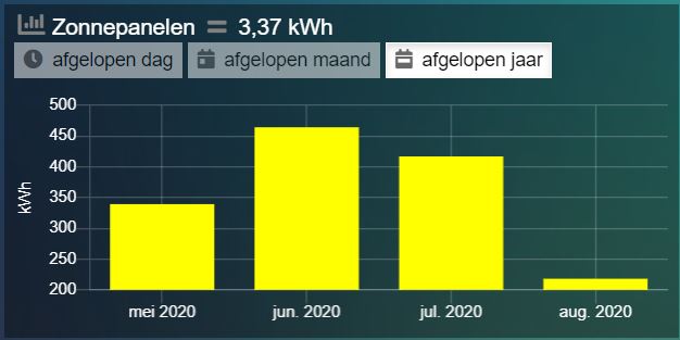

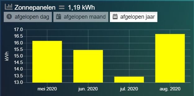

Ik like to display a graph of the solarpanels and groupBy month?
but instead of that it only displays the first day of the month instead of the kwh of the whole month.
does someone know what i am doing wrong?
I use the code:
"afgelopen jaar": {
range: 'year',
groupBy: 'month',
data: {
Solar: 'd.v_25',
Lokonli
Posts: 2296
Re: graphs -> year by Month
Post by Lokonli »
add the following block parameter:
   aggregate: 'sum'
NilsNijenhuis
Posts: 81
Joined: Friday 10 July 2020 22:56
Post by NilsNijenhuis »
superb, it work thanks!!!
