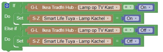

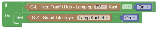

First thing I added in HA was to turn on one Tuya light (B) if I turned on a specific Ikea bulb (A) with the remote, This was quite easy to setup in HA and worked fine.
Now I'm trying the same using Blockly though it won't work like expected.
It does work when I turn on light A from Domoticz and does not when using the Ikea remote.
Blockly looks like this: Someone that can help me out?

Well it does work just not responding as fast as with Home Assistant unfortunately.
It takes about 20 seconds before Domoticz knows I pressed the Ikea remote button and the runs my script.
This was probably also my turn off script problem. Now I have on and off in one script and it works, Just wish it was a bit faster.

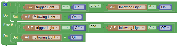

Did yo save your Blockly as a time triggered script or as device triggered ? You should also add a check to see if the light does not already have the required state. It will now send the signal regardless.Jasper79 wrote: Monday 27 July 2020 10:17 Well it does work just not responding as fast as with Home Assistant unfortunately.

The lag is probably caused by the plugin. When domoticz receives the updated status, the Blockly will react instantly.Jasper79 wrote: Monday 27 July 2020 11:01It was set to all, Now I set it to device and saved again. Still the same lag when switching.
If you could explain how to check required state it would be nice so I can learn from it
