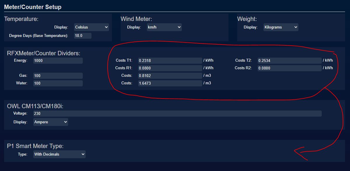

Would anyone know if it is possible to extend the P1 Smart Meter USB 'Meters/Counter' settings to include actual costs just like under the RFXMeters/Counters Dividers (see CostP1SmartMeter.JPG)
Using the hardware RFXCOM - RFXtrx433 USB 433.92 Mhz Transceiver I get this error below. I think because SET MODE does not save and not possible to define dB

Dutchy7 wrote: Thursday 23 July 2020 8:00 Would anyone know if it is possible to extend the P1 Smart Meter USB 'Meters/Counter' settings to include actual costs just like under the RFXMeters/Counters Dividers (see CostP1SmartMeter.JPG)
I guess you mis interpret the blocks on the tab. The costs for T1, R1, T2, R2 and Gas are (also) used for the P1 smart meter.

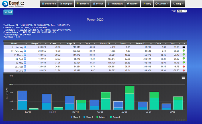

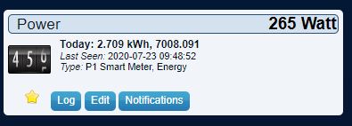

Hi waaren, yes I guess I have. Can you then explain where you see these total amounts? My dashboard widget does not show an amount. Neither in the 'LOG' is there any mention of a price total?
Re: P1 Smart Meter USB - Adding 'cost price' settings
Dutchy7 wrote: Thursday 23 July 2020 9:51 Hi waaren, yes I guess I have. Can you then explain where you see these total amounts? My dashboard widget does not show an amount. Neither in the 'LOG' is there any mention of a price total?
If you go to the 'LOG' and then click on 'Report' you will see a page where the costs are included.

Toppie! thanks that is what I was looking for. Much appreciated.
