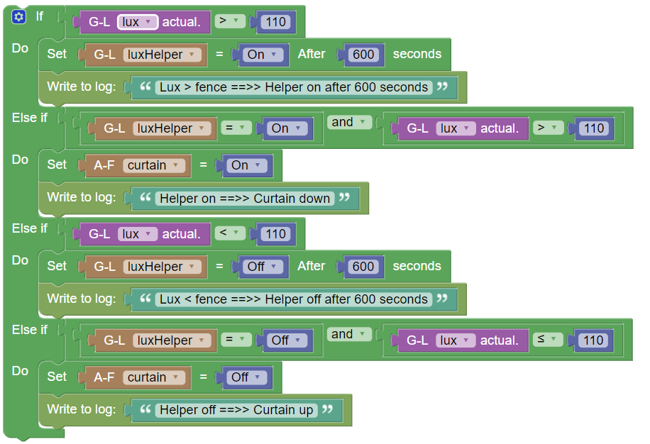

Posted: Saturday 18 July 2020 22:15
by wouterlet
Blocky should also be possible I guess. You could use a dummy switch. If lux is desired level then switch dummy switch on after 10 minutes.
Elseif dummy switch is on then close curtain.
Elseif lux is less then dummy switch off
Hope it's clear to you. But this makes a timer in blocky

wouterlet wrote: Saturday 18 July 2020 22:15 Blocky should also be possible I guess. You could use a dummy switch. If lux is desired level then switch dummy switch on after 10 minutes.
I guess you are right. This Blockly does work
XML (import in event editor)
[code<xml xmlns="http://www.w3.org/1999/xhtml"><block type="domoticzcontrols_ifelseif" id="tZGc@Y;ufY,:BW7G0QF/" x="-443" y="-505"><mutation elseif="3"></mutation><value name="IF0"><block type="logic_compare" id="Ht8:A7wX]L]5w}4P~YU|"><field name="OP">GT</field><value name="A"><block type="utilityvariablesGL" id="4a#nYF!EEz?(Kl!xfSL~"><field name="Utility">410</field></block></value><value name="B"><block type="math_number" id="mqcBOximchspTnduL?:K"><field name="NUM">110</field></block></value></block></value><statement name="DO0"><block type="logic_setafter" id="(g*^h@TQ2Irt`.Y6}V%n"><value name="A"><block type="switchvariablesGL" id="@{f-;t:WQBrRdS=$#ud@"><field name="Switch">409</field></block></value><value name="B"><block type="logic_states" id="w1Iub6|upF^f]fH(Va]V"><field name="State">On</field></block></value><value name="C"><block type="math_number" id="39AjF;}NL5ma#h1n_dxl"><field name="NUM">600</field></block></value><next><block type="writetolog" id="7M2*8L2H{K;:xFgT3sMU"><value name="writeToLog"><block type="text" id="3ub.l#P7m0jtdD-l:^|1"><field name="TEXT">Lux &gt; fence ==&gt;&gt; Helper on after 600 seconds</field></block></value></block></next></block></statement><value name="IF1"><block type="logic_operation" id="BIc^5I8QKe24%HA|lZ8]"><field name="OP">AND</field><value name="A"><block type="logic_compare" id="e?2D_+!_1u;S+-N:@-Z{"><field name="OP">EQ</field><value name="A"><block type="switchvariablesGL" id="Y/`Tj)77-DQf(C{bxPMq"><field name="Switch">409</field></block></value><value name="B"><block type="logic_states" id="loDPIW?K*KRCaH7]h;fu"><field name="State">On</field></block></value></block></value><value name="B"><block type="logic_compare" id="+Pz5V}NKDsU-petg0$;X"><field name="OP">GT</field><value name="A"><block type="utilityvariablesGL" id="v=?PC:v5-AEo{8qNJxVV"><field name="Utility">410</field></block></value><value name="B"><block type="math_number" id="00NsHFgy4gE8z{-wqH/o"><field name="NUM">110</field></block></value></block></value></block></value><statement name="DO1"><block type="logic_set" id="sG=Fw*A1;LNLi$M79XgN"><value name="A"><block type="switchvariablesAF" id="N60he$o84E}c9d06^%}C"><field name="Switch">411</field></block></value><value name="B"><block type="logic_states" id="Ura-Jw#tmR)C(bO^zi9W"><field name="State">On</field></block></value><next><block type="writetolog" id="h/P`%J]e!1GuJA0jOsz$"><value name="writeToLog"><block type="text" id="B2,%sFpfLY|TrubNsQyd"><field name="TEXT">Helper on ==&gt;&gt; Curtain down</field></block></value></block></next></block></statement><value name="IF2"><block type="logic_compare" id="UlLH4t*9~7v8p_KuE^Nn"><field name="OP">LT</field><value name="A"><block type="utilityvariablesGL" id="M/+q#bVqJ[Z5,2?C4`K)"><field name="Utility">410</field></block></value><value name="B"><block type="math_number" id="po|+@h[_x~2;!blz/S|]"><field name="NUM">110</field></block></value></block></value><statement name="DO2"><block type="logic_setafter" id="$?Q8Ap9o=r}6oI5_w#4N"><value name="A"><block type="switchvariablesGL" id=":eQ3[9kUnyL]=!,3cw+Y"><field name="Switch">409</field></block></value><value name="B"><block type="logic_states" id="VS4-H.LdYJeOxyyE-r%{"><field name="State">Off</field></block></value><value name="C"><block type="math_number" id="0fy-Y$.4f`lA}-Wp?2]c"><field name="NUM">600</field></block></value><next><block type="writetolog" id="0/jv:}5N|.x,!jPr$[5r"><value name="writeToLog"><block type="text" id="Ih~B%[:%`E!Xm^Dp9FL8"><field name="TEXT">Lux &lt; fence ==&gt;&gt; Helper off after 600 seconds</field></block></value></block></next></block></statement><value name="IF3"><block type="logic_operation" id="Do^:2Ed8hiXqCAv:oFoF"><field name="OP">AND</field><value name="A"><block type="logic_compare" id="~K{{o.6{1o4nvT.ZwDQH"><field name="OP">EQ</field><value name="A"><block type="switchvariablesGL" id="jH~jCtD-3V,?|zR.Cap9"><field name="Switch">409</field></block></value><value name="B"><block type="logic_states" id="7jf:JZ4UY-@AY-;54r$S"><field name="State">Off</field></block></value></block></value><value name="B"><block type="logic_compare" id="5CTm9NQ#zV*`}O#ND5LX"><field name="OP">LTE</field><value name="A"><block type="utilityvariablesGL" id="+8b,Q]aDgNM$`TM5KwD6"><field name="Utility">410</field></block></value><value name="B"><block type="math_number" id=".U`,APc;3qW1KIO[rt?W"><field name="NUM">110</field></block></value></block></value></block></value><statement name="DO3"><block type="logic_set" id="qoqeyde*bW:8,3oUqtOF"><value name="A"><block type="switchvariablesAF" id="tQ=4]h.2!|(n+Xcu!:s]"><field name="Switch">411</field></block></value><value name="B"><block type="logic_states" id="6j9GHVc$9qNtPcb=ekc."><field name="State">Off</field></block></value><next><block type="writetolog" id="#=;QG.IWKUJ3{{Sc!m(n"><value name="writeToLog"><block type="text" id="v:HOF.a%cD=io]%H5pLx"><field name="TEXT">Helper off ==&gt;&gt; Curtain up</field></block></value></block></next></block></statement></block></xml>
