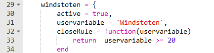

I'am playing around with this script, but I run into a problem. OMW does not generate a gust value. I retrieve this value via NodeRed from Buienradar and make it a user variable. I adapted the script to that (I guess?). In the log I see an error that I cannot fix myself. What is wrong?
Script Sun screen.png (6.92 KiB) Viewed 2949 times
Thanks in advance!
Re: Sunscreen script
Jan Jansen wrote: Monday 27 July 2020 16:36 I'am playing around with this script, but I run into a problem. OMW does not generate a gust value. I retrieve this value via NodeRed from Buienradar and make it a user variable. I adapted the script to that (I guess?). In the log I see an error that I cannot fix myself. What is wrong?
If you post a script issue then please share your complete code and log within code tags </>.
If you need the value of a uservariable you should use something like domoticz.variables('varName').value

I've modified the script for my needs, but the problem is when it has triggered 1 treshold the script stops.
I like to check all sensors and switch those at the treshold until it has checked all sensors.
This is was i have made until now

    active = true,
        timer = {'every 5 minutes at 07:00 - 21:00'},
        devices = {727,728,290},
    logging = {
                state = domoticz.LOG_ERROR,
                marker      = scriptVar
execute = function(domoticz)
-- Define all the sensors which needs to be considered for the sunscreen to close
local sensors = {
    Screen_Erker1 = {
        active = true,
        device = 607,
        closeRule = function(device)
            return device.level < 99
    Screen_Erker2 = {
        active = true,
        device = 610,
    Screen_Erker3 = {
        active = true,
        device = 606,
    Screen_Erker4 = {
        active = true,
        device = 609,
    Screen_Erker5 = {
        active = true,
        device = 611,
            return device.level > 99
    Screen_Wnk_gr = {
        active = true,
        device = 493,
    Screen_Wnk_kl = {
        active = true,
        device = 612,
    Screen_Deur = {
        active = true,
        device = 605,
    Screen_Thomas_1 = {
        active = true,
        device = 604,
    Screen_Thomas_2 = {
        active = true,
        device = 608,
    Screen_Slaapkamer = {
        active = true,
        device = 613,
local RegenData     = domoticz.devices(445)
local MowerState            = domoticz.devices(727)
local MowerRun              = domoticz.devices(728)
local MowerAction           = domoticz.devices(730)
    if (RegenData.rainRate > 0) and (MowerRun.level == 'On') then
        MowerAction.setLevel(50)
        dz.log('Regen : ' .. dz.utils.round(RegenData.rainRate,2) .. ' mm', dz.LOG_FORCE)
        dz.log('Regen : Mower gaat naar huis', dz.LOG_FORCE)
        -- Check all sensor tresholds and if any exeeded close sunscreen
        for sensorType, sensor in pairs(sensors) do
            if (sensor['active'] == true) and (RegenData.rainRate > 0) then
                local device = domoticz.devices(sensor['device'])
                local closeRule = sensor['closeRule']
                domoticz.log('Checking sensor: ' .. sensorType, domoticz.LOG_FORCE)
                if (closeRule(device)) then
                    device.switchOn()
                    domoticz.log(sensorType .. ' treshold exceeded', domoticz.LOG_FORCE)
                    -- Return early when we exeed any tresholds
                    return
                domoticz.log('Sensor not active skipping: ' .. sensorType, domoticz.LOG_FORCE)
Thanks !!
