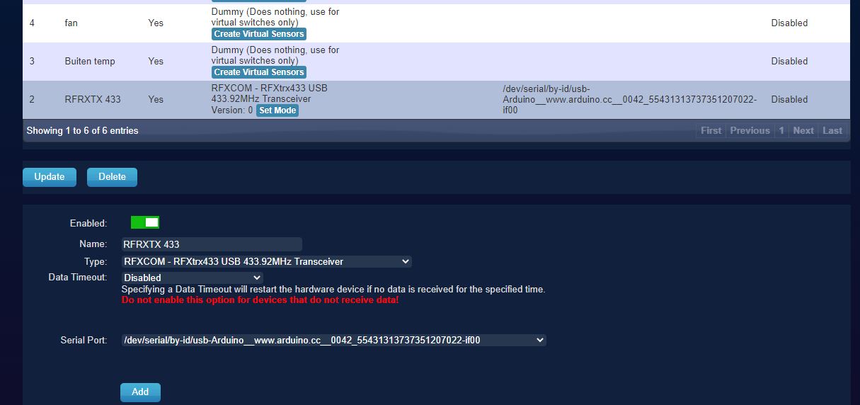

Domoticz does not show dev/usb0 to be connected as shown in many paper and video samples.
Needless to say it does not work if I select any of the ports shown in the attachments.
dev/ttyACM0 and a reboot is no joy either as refered to in an other google search.
What can be the cause?
Any simple solution to track down the root problem?

Re: RFLink no dev/usb to select in Domoticz
Er, not sure if I've misread your post but you say you have an RFLink (ATMEGA 2560) so why have you added and RFXCom as the hardware and not an RFLink ?

Dave,
Your correct. My fault.
Thanks for your time.
I use the DIY RFLINK firmware with ATMEGA 2560.
Do not know why I try to connect with RFXCOM.
