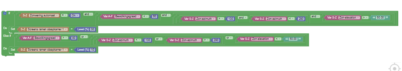

ensingg wrote: Thursday 25 June 2020 9:58 HI,
I am thinking for a script to control my blinds.
I try to automate my sun protection by trial and error. I still have some time, our new house is under construction. In my case it concerns several screens, each with a different geographical orientation. A selector switch has been created for each screen with the following buttons (Up = level 10, Stop = level 20 and Down = level 30). There is also a master with the same buttons and a switch that allows the automation to be turned on/off.
From the web I get the following information via Nodered:
Cloud coverage (Integer), Sun azimuth (Integer) and Sun elevation (String), they become user variables ( see:https://www.domoticz.com/forum/viewtopi ... 56#p250856).
After I did the above, I started scripting. I started with DzVents, but at the time it is still a bridge too far. So I fell back on the well-known Blockly.
For me, the following script works.
The values entered in the script must be set in practice.
The master switch can be triggered to protect all screens against strong winds or to close all the screens against the cold in winter.
Perhaps later solar power in relation to indoor temperature will be added. It will also be necessary (need some help) to avoid unnecessary closing and opening of the screens, for example no more than once every 30 minutes.
Perhaps also interesting for me to include the solar energy in relation to the indoor temperature in the script.
Maybe also interesting for you (https://flows.nodered.org/node/node-red ... n-position)
