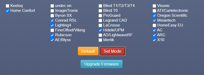

So I just received theses devices.
To integrate it, I used the switches panel, then the button learn Light/switch
I press the button of the device but Domoticz do not "find" it !
Any clues ?
Any clues ?
b_weijenberg
- Posts: 524
- Joined: Friday 12 July 2013 18:13
- Target OS: -
Re: Ev1527 Chinese devices
Use the latest Pro1 firmware in the RFXtrx433E.
Check with RFXmngr if the button is received.
Enable "add new devices" in Domoticz for 5 minutes.
Thanks a lot
It works now

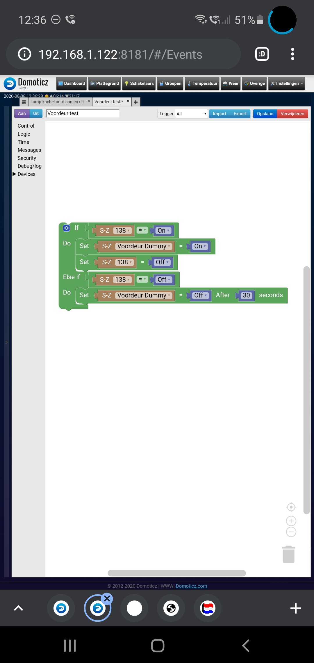

My RFLink found the front door and it does say ON all the time, If set manually to OFF it set ON when opening the door.
Could you give more details on how to make a script that records if the door has been opened?

How do you see the device details on the device tab? Do you see Open / Closed or On / Off in the data column?Jasper79 wrote: Saturday 08 August 2020 11:24 Could you give more details on how to make a script that records if the door has been opened?
Jasper79
- Posts: 85
- Joined: Sunday 26 July 2020 8:37
- Domoticz version: 2020.2
On/Off, once its on it does not go off by itself.
I've been trying and it does seem to work like this.
- waaren
- Posts: 6028
That will work but does update your dummy device when there is any device activity on your system. Can you try changing the devicetype to doorcontact (on the switch tab) and use below dzVents script to toggle the contact n seconds after opening?Jasper79 wrote: Saturday 08 August 2020 12:38 On/Off, once its on it does not go off by itself.

Jasper79
- Posts: 85
Setting it to door contact shows a closed/locked door icon and state closed.
Then opening the door shows a open door and state open.
Then nothing else happens after closing the door, It does not seem to reset.
On device I changed the name Door To Voordeur as in my devices list.
Everything else is untouched.

Jasper79
- Posts: 85
Fixed that,
Now it works.
I'll try for a couple a days before I move on to a siren

A quick question before I post my version as I don't want to make an idiot of myself.
Reading this script am I correct that after the door opens there is a delay and the script sets the door to closed again even if it's still open ?

Indeed, why,. Well because the cheap sensor does not send a message when it's closed, it only sends a message when it opens so for the system it stays open forever.
I will need to buy new sensors some time.
OK, thanks for the update, you should still have been able to reset the status in the switch itself instead of bothering with a script, simply set the off delay in the edit tab for the switch to say 20 seconds.
Dave
Dave
Thanks, I didn't find a way to set it in the switch.
These are old chuango 433mhz door sensors that just send a signal to the main unit as far as I know.
Setting it to 20 seconds does not make much of a difference I think because like this morning the front door is open for a few hours to try and cool down the house.
I'm willing to try any changes, I'm pretty new to this so I'm relying on the community.
