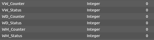

Create the user variables (integer) 'XX_Counter' and 'XX_Status' for every device you would like to use.
Change 'iXX_Counter_Uservar' and 'iXX_Status_Uservar' in the script to the names of the created user variables.
