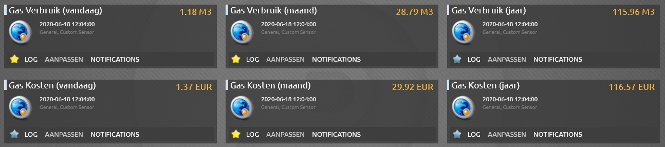

dzVentz timer script for showing gas consumption & cost per day, month and year in 6 virtual custom sensors.
Change 'inputDevice' in the script to the name of your P1 gas device.
Create 3 virtual custom sensors (Aslabel: m3) and make sure the device names of these custom sensors correspond to the names of the outputDeviceConsumptionX variables in the script.
Create 3 virtual custom sensors (Aslabel: EUR) and make sure the device names of these custom sensors correspond to the names of the outputDeviceCostX variables in the script.
You can also change the cost per unit and fixed transport cost values.
Gas Custom Sensors.jpg (176.98 KiB) Viewed 2646 times

                device.updateCustomSensor(value)
                dz.log(device.name .. " ==>> Previous value: " .. currentValue .. " ; New value: " .. value,dz.LOG_DEBUG)
        -- Function for JSON processing --
        local function ProcessJSON(t)
            local todayVolume = 0
            local monthVolume = 0
            local yearVolume = 0
            local daysCounterMonth = 0
            local daysCounterYear = 0
            local currentDayIdentifier = dz.time.rawDate:sub(1,10)
            local currentMonthIdentifier = dz.time.rawDate:sub(1,4) .. '%-' .. dz.time.rawDate:sub(6,7)
            local day = 86400 -- (24 * 60 * 60)
            for index, inputDevice in ipairs(t) do
                if inputDevice.d == currentDayIdentifier then
                    todayVolume = todayVolume + inputDevice.v
                if inputDevice.d:match(currentMonthIdentifier) then
                    monthVolume = monthVolume + inputDevice.v
                    daysCounterMonth = daysCounterMonth + 1
                if inputDevice.d:match(dz.time.year) then
                    yearVolume = yearVolume + inputDevice.v
                    daysCounterYear = daysCounterYear + 1
            dz.log('daysCounterMonth: '  .. daysCounterMonth, dz.LOG_DEBUG)
            dz.log('daysCounterYear: '  .. daysCounterYear, dz.LOG_DEBUG)
            dz.data.power.consumptionToday = todayVolume
            dz.data.power.consumptionMonth = monthVolume
            dz.data.power.consumptionYear = yearVolume
            dz.data.power.costPowerUnit = costPowerUnit
            dz.data.power.costPowerFixedDay = (costPowerFixedDay or 0)
            dz.data.power.daysCounterMonth = daysCounterMonth
            dz.data.power.daysCounterYear = daysCounterYear
        -- Main -----------------------------------
        if item.isHTTPResponse and item.isJSON then
                ProcessJSON(item.json.result)
        elseif item.isTimer or item.isDevice then
            ConsumptionGetGraphData(inputDevice.id, 0)
            updateCustomSensor(outputDeviceConsumptionToday, makeConsumption(outputDeviceConsumptionToday))
            updateCustomSensor(outputDeviceConsumptionMonth, makeConsumption(outputDeviceConsumptionMonth))
            updateCustomSensor(outputDeviceConsumptionYear, makeConsumption(outputDeviceConsumptionYear))
            updateCustomSensor(outputDeviceCostToday, makeCost(outputDeviceCostToday))
            updateCustomSensor(outputDeviceCostMonth, makeCost(outputDeviceCostMonth))
            updateCustomSensor(outputDeviceCostYear, makeCost(outputDeviceCostYear))
            dz.log('Error retrieving data. Result is: ' .. item.statusText ..' ; Response is: ' .. item.data,LOG_ERROR)
