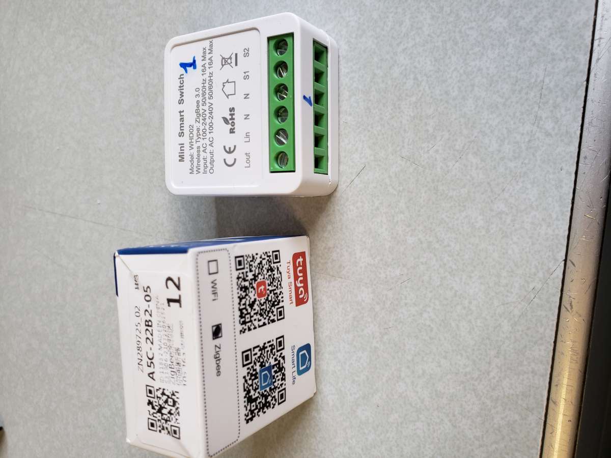

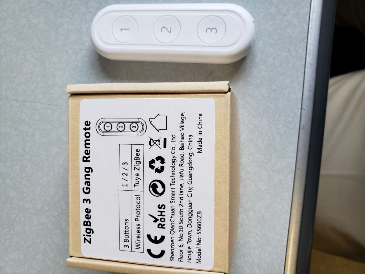

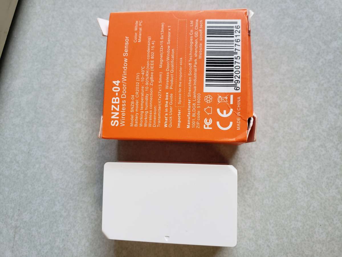

This is what I am using after several unsuccessful attempts to pair GD00Z-1. I use Conbee2 and Deconz.
1.Sonoff SNZB-04 Door sensor -replace magnetic sensor with tilt sensor;
2.Tuya WHD02 Mini Smart Switch - modify relay output, you have to isolate the contacts;
3. Use Zigbee 3 Gang Remote and Lua script
If anyone is interested, I can post more info

anp21 wrote: Thursday 05 August 2021 21:17 This is what I am using after several unsuccessful attempts to pair GD00Z-1. I use Conbee2 and Deconz.

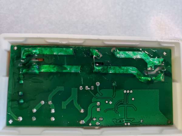

Hi anp21!!!
¿how did you do to modify WHD02 to convert it in dry relay?
Thanks in advance!!

Sorry for the delay, attached is zip file with all pictures. Also you can use no-name Zigbee switch, much easier to modifyImage
