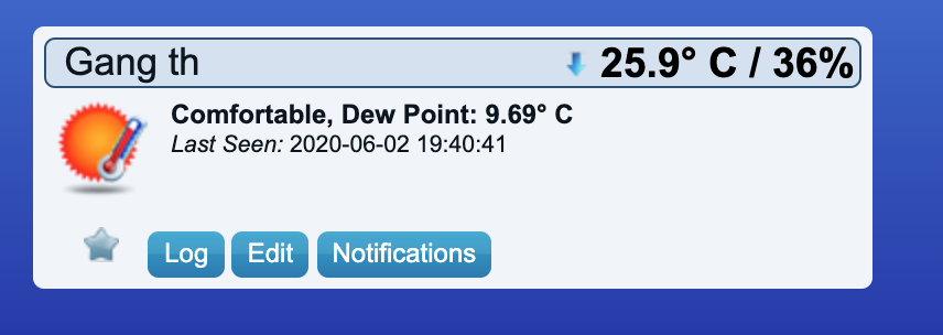

Jimster wrote: Tuesday 02 June 2020 16:20 The device is set to used in Domoticz? (blue arrow should point to the left in Devices tab).
yes it is
Screenshot 2020-06-02 at 19.41.00.png (62.78 KiB) Viewed 509 times

Lokonli
Posts: 2292
Re: Temp/Hum device won't show up in Dashticz
Post by Lokonli »
And if you select it as favorite?
(Or set use_favorites to 0 in CONFIG.js)

Lokonli wrote: Tuesday 02 June 2020 19:55 And if you select it as favorite?
Hi Lokonli
Yes that did it, I'm using Dasticz for a while now, never experienced the favourite-dependency.
Thanxzz for the tip
