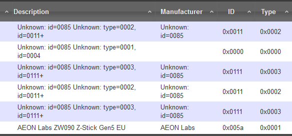

The device is not reconized in the Zwaves device list.
Is there a link with my problem ?
