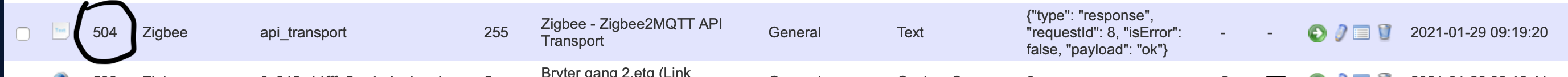

You need to set your API transport IDX in this line:
cmd1st = ("curl --globoff 'http://127.0.0.1:8080/json.htm?idx=504&param
change the number 504 to the number you have in your device list.
Skjermbilde 2021-01-29 kl. 09.25.24.png (75.48 KiB) Viewed 1739 times
