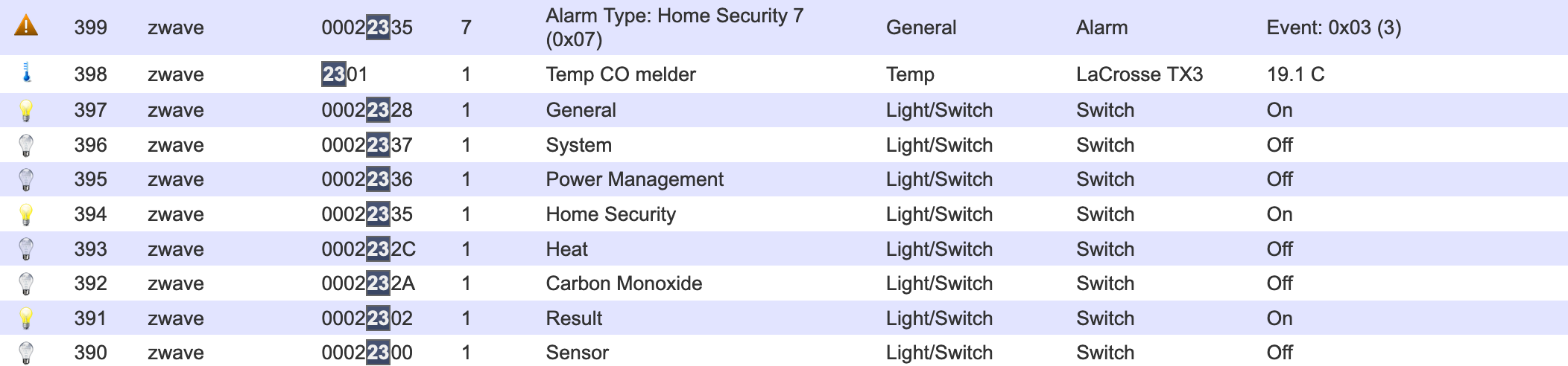

It is not that no devices appear. Instead of the CO value, a switch (on / off) Carbon Monoxide appears.
See attached picture. That's why I thought there should be something different in the XML file or that Domoticz misinterprets this.

I see, the device is not handled as should - a CO2 Sensor, I checked the XML and this is correct, so I think there should be a wrong association in Domoticz Zwave control - there are a number of Forum topics about the CO2 level missing, also under 1.4, but not a solution.
I will check the code - I am not a developer but I can read the code
might take a while ....
