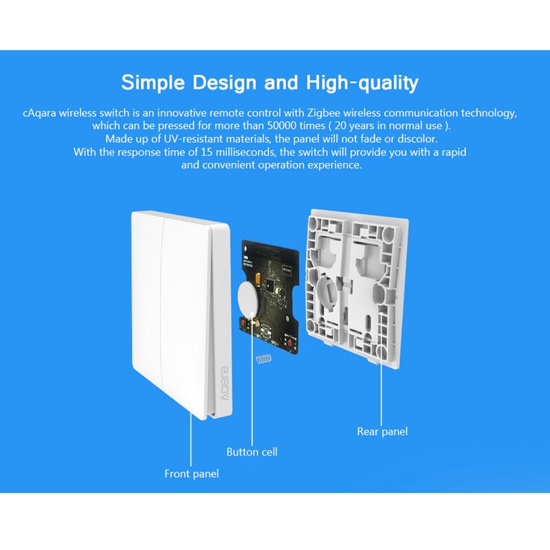

I was too early. I have likewise problem with my single button Aqara battery wall switch. It seems connected, but no reaction to switching, nothing in logs.
I had an hard time to re-include my switch after I removed it yesterday. Did git pull (now on 4.8.22) an re-including only was successfull after 8 times or so. But I read that is more often a problem with Aqara. Now I succesfully included it, it is still not reporting switches.
It is this switch:
Aqara-Wireless-Switch-Single-Double-Key-Button-Smart-Light-Control-ZigBee-Version-for-Mi-Home-APP.jpg_960x960.jpg
Aqara-Wireless-Switch-Single-Double-Key-Button-Smart-Light-Control-ZigBee-Version-for-Mi-Home-APP.jpg_960x960.jpg (61.75 KiB) Viewed 1362 times

Yep, that’s it. I never have problems binding Aqara devices. Only a few THB devices last week with low battery.
Maybe your battery is low also

OK, I changed the battery. Unpaired the switch, and re-paired it. Paring went OK first try. However still no reaction to pushing the switch.
EDIT: saw there was again an update of the plugin. After new git pull it works... Thanks Pipiche!
