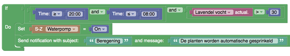

I made this blocky:
I want that only in the evening/night (between 20.00 and 8.00 hour) my irrigation (waterpomp) goes on when my 'lavendel voch' is above 30 (cb).
It's switch off itself.
Is this the correct way or do I have to use variables? And how do I use this?

I think it could be able to work, but time can't be after 20:00 and before 8:00. Blocky only thinks in one day. Change the and between the time in or and I think it will work.

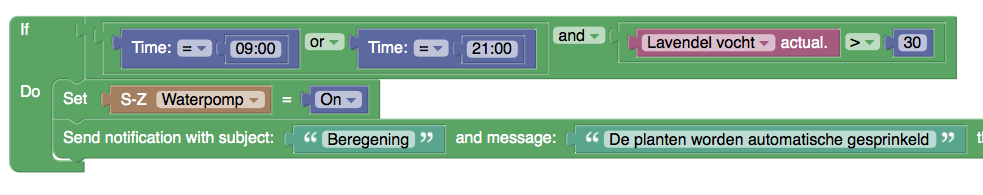

this is my blocky now (I switched to fixed time):

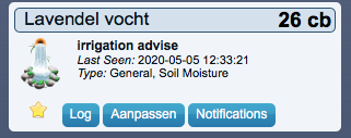

'Lavendel vocht' is type 'General, Soil Moisture'
- waaren
- Posts: 6028
Re: Irrigation garden with buienradar
Because the Soil Moisture device stores its moisture value in another place then most other devices (it uses nValue while most other utility devicetypes use sValue), Blockly is not able to evaluate the value.
You could try below dzVents alternative.
timer =
'at 09:00',
'at 21:00',
logging =
level = domoticz.LOG_DEBUG, -- set to domoticz.LOG_ERROR when OK
marker = 'Beregening',
execute = function(dz)
local soilDevice = dz.devices('Lavendel vocht')
local moisture = soilDevice.moisture
local pump = dz.devices('Waterpomp')
dz.log(soilDevice.name .. ' measures a moisture of ' .. moisture .. ' cb ',dz.LOG_DEBUG)
if moisture < 30 then -- Should this be more ( > ) or less ( < )then 30 ?
pump.switchOn()
pump.switchOff().afterSec(3600)
dz.notify('Beregening', 'De planten worden automatisch beregend',dz.PRIORITY_NORMAL)
}Debian buster, bullseye on RPI-4, Intel NUC.

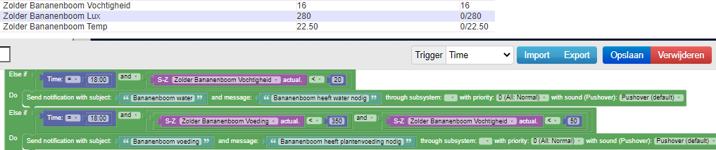

Getting this errors:
2020-08-21 10:03:00.354 Error: EventSystem: Lua script error (Blockly), Name: Tijd Planten meldingen_5 => [string "result = 0; weekday = os.date('*t')['wday']; ..."]:1: attempt to compare nil with number
2020-08-21 10:03:00.354 Error: EventSystem: Lua script error (Blockly), Name: Tijd Planten meldingen_6 => [string "result = 0; weekday = os.date('*t')['wday']; ..."]:1: attempt to compare nil with number
I have got 4 sensors, and want to get notifications like you can see in my Blockly.
Can you please help me how to make a script in dzVents so this works?
I already edited your script so it works for one of the sensors for the water. How to make this script working for all 4 plants and also the plant food sensors?
timer =
'at 09:39',
logging =
marker = 'Plant Meldingen',
local soilDevice = dz.devices('Zolder Bananenboom Vochtigheid')
if moisture < 20 then -- Should this be more ( > ) or less ( < )then 30 ?
dz.notify('Bananenboom water', 'De Bananenboom moet water hebben',dz.PRIORITY_NORMAL)
}- Attachments
- bananenboom.png (31.43 KiB) Viewed 4371 times
Raspberry Pi 4 With Domoticz - RFXCom - Tuya Wifi LED lights - Chuango Alarm - Zwave+ - Zigbee2MQTT - Anna Thermostat - Broadlink IR, P1 - Eufy Robo Vacuum - Worx Robo Mower
