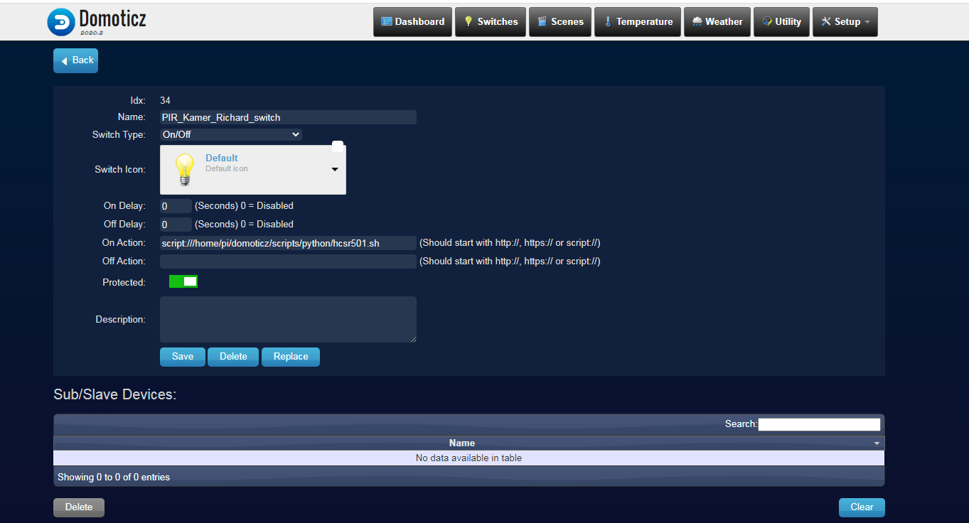

You could make a dummy switch and trigger the bash script in there from the 'on action' line as: script://run-script.sh and save this script in the domoticz/scripts folder.

rick8245 wrote: Wednesday 29 April 2020 13:17 Where do i find the ' On Action' item ?
Is that at Events ??
In the created dummy switch.

No it is the same. The page I show is from the switches tab and edit the dummy switch.

Post by rick8245 »
Thanks AllesvnZelf. It works
