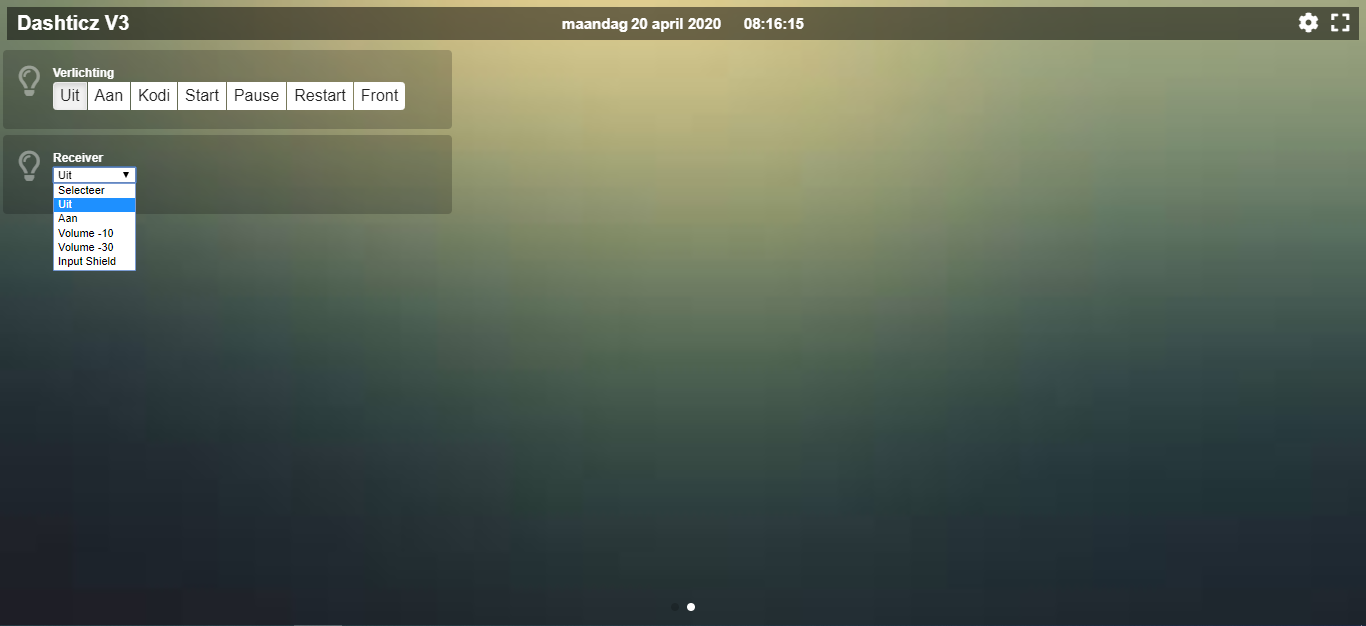

I have all my selector switches shown as buttons instead of a drop down list through config['selector_instead_of_buttons'] = 0.
But there's still one selector switch showing as drop down. What am I doing wrong?

That's a bit strange indeed.
What are the device types and subtypes of the two devices?
You can request them via:
http://<domoticz ip:port>/json.htm?type=devices&rid=57
http://<domoticz ip:port>/json.htm?type=devices&rid=78
[code]
Which exact Dashticz and Domoticz versions are you running?
fvdp80
Posts: 70
Joined: Tuesday 14 August 2018 8:22
Domoticz version: 4.10303
Re: Selector switch format
Post by fvdp80 »
Device 57:
"Type" : "Light/Switch"
"SubType" : "Switch"
Device 78:
"SubType" : "Selector Switch"
Domoticz version: 2020.1 (build 11942)
Dashticz version: 3.4.4 beta
Lokonli
Posts: 2296
Post by Lokonli »
There is an option in Domoticz to choose the button display style for each device. Can you check those?
fvdp80
Posts: 70
Post by fvdp80 »
That was it! Changed it and the buttons are shown the right way in Dashticz.
Thx!
