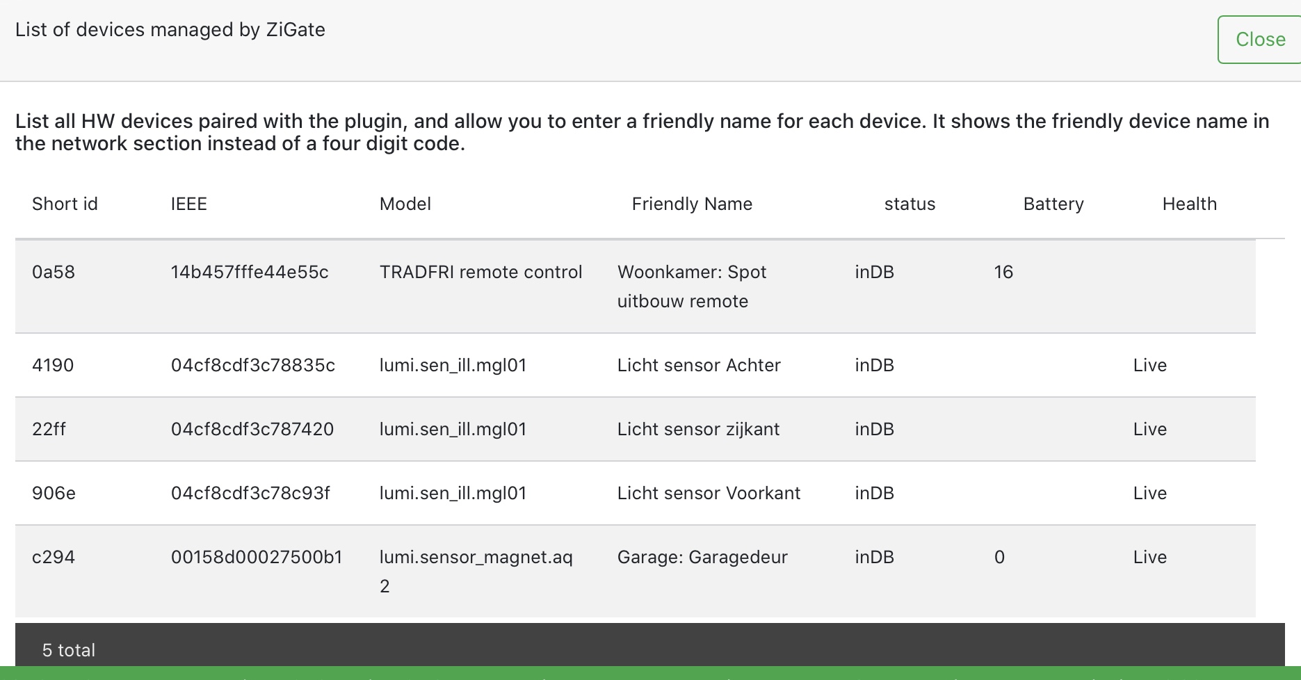

Re: Zigate and Xiaomi light sensor
Also the plugin doesn't show the battery percentage and the sensors are in the network for 2 weeks now.
could you please provide the export of Plugin Raw Device (JSON) ?
SO iI guess we are talking about the new Lux sensor. Please do update the beta branch. This should work now
Great, it works. First one has a reported battery percentage, I'm sure the other two will follow.
