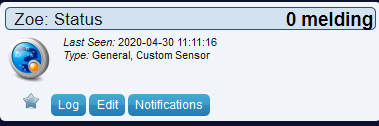

Apparently you can update the My Z.E. Connect 12 months in the R-Link store for free without visiting the garage so I did.
For the Status I use here a Custom Sensor that works great with numbers but not with text.
I was expecting a text like 'Unplugged'. Do I have to change the device to a Text sensor?
Regards,
Johan
jvrietveld
Posts: 15
Joined: Wednesday 25 December 2019 16:23
Domoticz version: V2020.2
Location: Limburg
Re: Renault Zoe API
Post by jvrietveld »
This is working for me.
