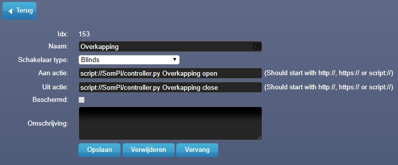

Now i want to use the command in domoticz but i cant get it to work.
Add Switch.jpg (34.78 KiB) Viewed 6814 times
I get the error :
Error executing script command (/home/pi/domoticz/scripts/SomPi/controller.py). returned: 256
My guess is that my line is not correct in the domoticz switch.

You have 2 options for the script.
1. Use relative path:
In this case it is assumed that the script is installed in ~/domoticz/scripts
On action would be: script://your_script
2. Use absolute path:
The on action would be e.g.: script:///home/pi/domoticz/scripts/your_script.
Mind the difference in 2 // and 3 ///.
You seem to use option 1 (Relative path)
So your script should be: script://SomPi/controller.py parameter1 parameter2
So 2 // and I think your script is correct.

I had to remove the folder 'remotes' to the right place in /home/pi
But still when its executed in domoticz i get error 256
Is it because of the reply from the script that it doenst work in domoticz?
I tried making overkappingclose.sh file to execute and it works in command line but not in domoticz. Same result 256
#!/bin/bash
/usr/bin/python2 /home/pi/domoticz/scripts/controller.py Overkapping close

You wrote:
Maybe i should mention it before but domoticz is run by user pi and not by root.
I have been focused on the fact that Domoticz runs as root, which is the case by default.
That changes the way we have to think and you can forget all previous links and suggestions.
I overlooked also an important error message:
IOError: [Errno 2] No such file or directory: 'remotes/Overkapping.txt'
I see also: -rwsr-xr-x 1 root root 4516 Apr 13 16:03 controller.py
I advise you to remove the setuid permission, as the controller.py is owned by root. Having setuid permission on root owned files opens your system to intrusion.
sudo chmod 755 controller.py
And you can also change the ownership back to the pi user
sudo chown pi.pi controller.py
Having done these things, have a look at: https://www.domoticz.com/forum/viewtopic.php?t=7465
The answer is probably there.
You need an intermediate script.
Change the script in Domoticz for ON to: ///home/pi/domoticz/scripts/controllerON.sh
Create a script in the scripts directory, called controllerON.sh
Contents controllerON.sh:
#!/bin/sh
python controller.py Overkapping open > /dev/null 2>&1 &
exit 0
And the same with the script for OFF: ///home/pi/domoticz/scripts/controllerOFF.sh
Contents of controllerOFF.sh:
#!/bin/sh
python controller.py Overkapping close > /dev/null 2>&1 &
exit 0
I hope you have success, but at least I wish you a nice weekend.
