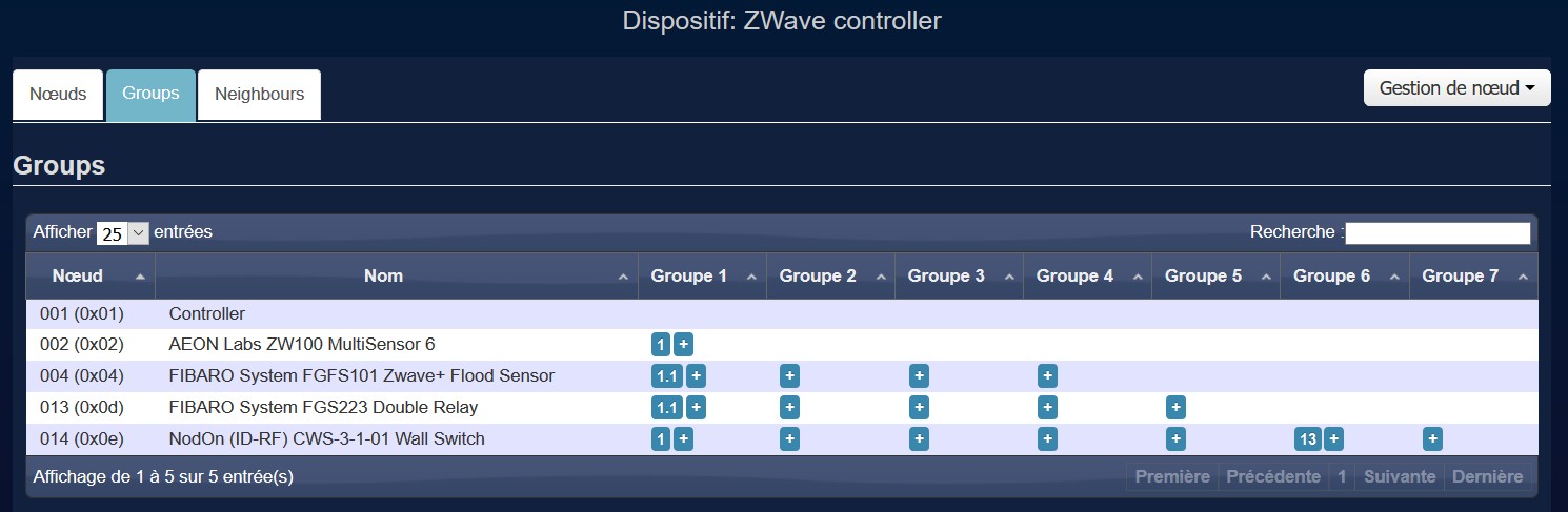

Hello all,
I'm sorry if the answer is obvious, or my question has already been answered...
I have a Raspberry Pi 3B running last stable version of Domoticz 2020.1.
With a Z-wave USB stick from Cyrus Technology.
I have 4 Z-Wave devices which I could properly include in the Z-Wave network.
-Fibaro flood sensor
-Aeotec 6-in-1 sensor
-Nodon dual wall switch
-Fibaro dual relay
Problem is I need to associate the dual switch with the dual relay, with groups.
So switch 1 of the nodon switch would drive relay 1 of the Fibaro dual relay.
Same association for switch 2, relay 2.
Problem is in groups association.
Nodon dual switch has adequate groups (for each switch).
But I am unable to associate single relays in the switch groups. I can only associate the entire Fibaro dual switch.
In this way, relays have no reaction to switches
Is thie Z-Wave feature supported in Domoticz ?
Thanks !

I precisely went to this menu. Wanted to associate node 13.1 in group 6 of node 14.
So I type "13.1" in the "Add to node" menu.
Unfortunately after refreshing, associated node is 13 instead of 13.1

I got an answer from a reseller :
This configuration won't work, just because Nodon dual wall model CWS-3-1-01 switch doesn't support multichannel association.
Solutions could be :
-either to have another dual switch which would support multichannel association (for example Aeotec wallmote quad)
-or to have one Fibaro relay per channel (and not one dual channel relay)
Thanks indeed to the Domoticz community !

.1 is the first channel of the Fibaro FGS-223 dual relay (multichannel)
.2 is for the 2nd relay
