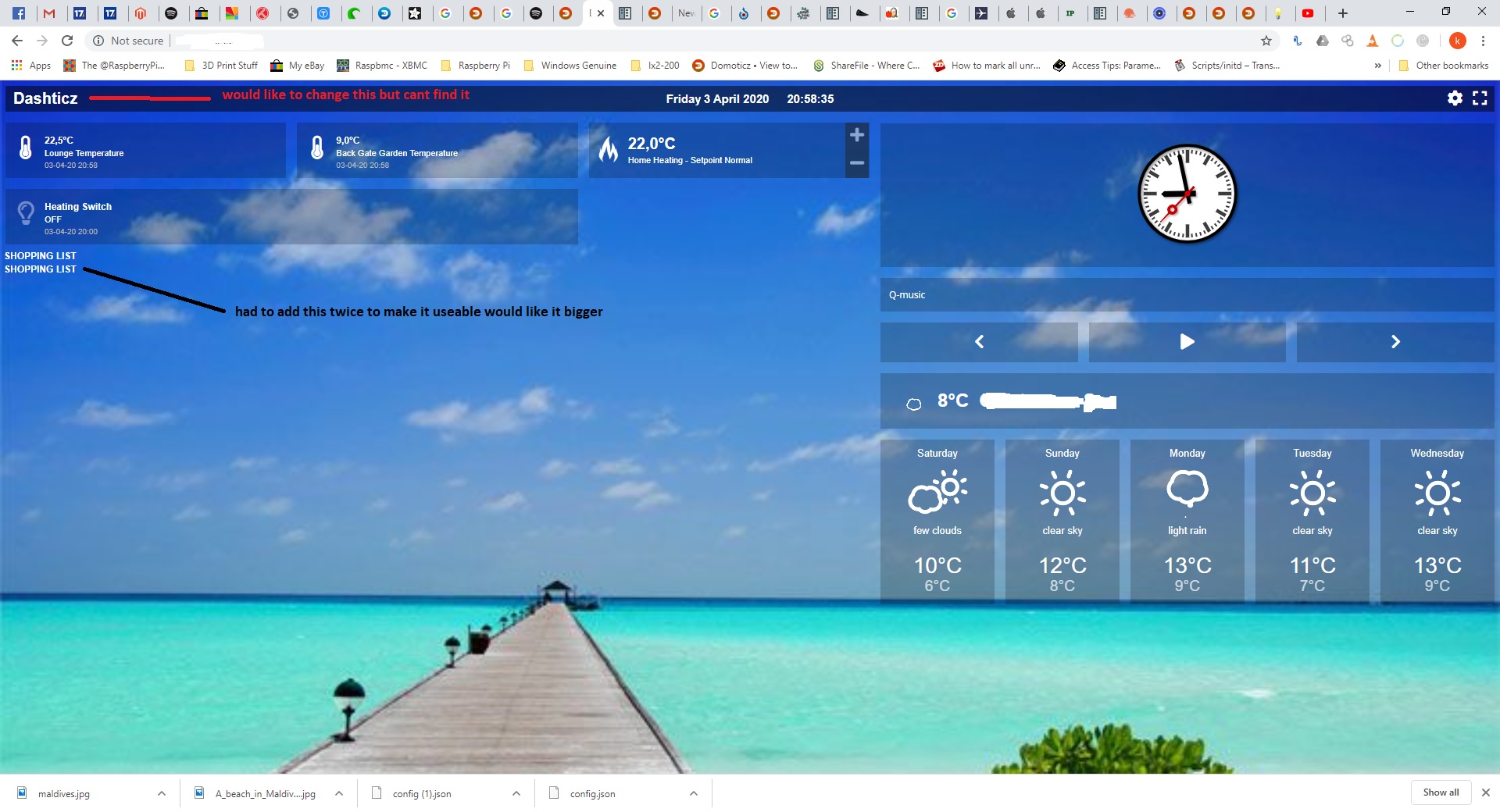

1, I would like a 2nd maybe 3rd tab that I can swipe across to, I have seen the reference to it (enable_swiper), but no idea how to go about creating multiple pages
2, The attached image shows the 2 problems I would like to address. I have a URL link to a shopping list site, but the text is small on the Ipad
so I have made 2 entries to give an better chance of getting it when you tap, there must be a better way to increase the size.
3, I have tried adding with no success a Hikvision camera to the bottom left, but all I get is errors and Dashticz wont load, I know the URL certainly for Snapshot as I use it in Domoticz, for several cameras

The next part doesn't work:
blocks[313,336,58,298]= {
    width:8
You have to set the width for each block individually, like:
blocks[313] = {
  width: 8
The max of the sum of the width of the blocks in a column is 12, so if you want to have 2 blocks on one row width should be 6. With three blocks width should be 4 (or 2,4,6 for instance)
There is something strange with your buttons (shopping list): they should have a background.
To make the text of button titles bigger, add the following to custom.css:
.button .dt_title {
     font-size: 30px
To add a second screen add the following to CONFIG.js:
blocks['col4title'] = {
	type: 'blocktitle',
	title: 'Column 4, column width is 4'
blocks['col4block1'] = {
	type: 'blocktitle',
	title: 'block width is 6',
	width: 6
blocks['col4block2'] = {
	type: 'blocktitle',
	title: 'block width is 3',
	width: 3
blocks['col5title'] = {
	type: 'blocktitle',
	title: 'Column 5, column width is 8'
columns[4] = {
	width: 4,
	blocks: ['col4title', 'col4block1','col4block2']
columns[5] = {
	width: 8,
	blocks: ['col5title']
screens[2] = {
	background: 'maldives.jpg',
	columns: [4,5]
I've added a few blocktitle blocks in the first column of the second screen. (=column 4)
