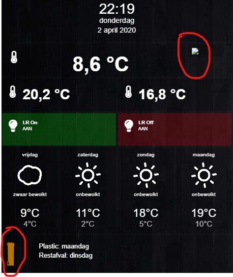

Can somebody help me.
I had to reinstall dashticz after a crash of domoticz.
After installation of version 3.3.3.1 everything works except:
My trashcan picture is deformed (slimmer than the actual size)
and the moon phase pictures are not showing.
I did some checking on the moon phases and html inspect says that
"You don't have permission to access this resource. Apache/2.4.38 (Debian) Server at 192.168.178.150 Port 8082"
The moon library and pictures have the right permissions so I think someting is not right with Apache permission right but I dont know how to fix it.
Can somebody help me or give me a hint, also on the garbage picture.

I just setup my dashticz and ran into the same issue:
192.168.178.56/:1 GET http://192.168.178.56:8082/img/moon/ 403 (Forbidden)

Please check that the files and folders are accessible for root.
Can you post here how you defined your button for the moon image in CONFIG.js?

Hi Lokonli,
folder moon has permission: drwxr-xr-x
and the png files have: -rw-r--r--
My config.js:
buttons.moon = {
width:2,
isimage:true,
refreshimage:60000,
image: 'moon'
//Definition of columns
columns = {}
columns[1] = {
// blocks : ['clock', 'sunrise', buttons.moon],
blocks : [
'clock',
// '192_1',buttons.moon,
'570_1',buttons.moon,
'875_1','869_1',
's3','s4',
// 'currentweather_big_owm',
'weather_owm',
'garbage',
'sunrise'],
width: 4
Thanks.

Permission on my pi:
drwxr-xr-x 5 pi pi 4096 Apr 4 22:55 img
config.js
buttons = {}
buttons.moon = {
  width:12,
  isimage:true,
  refreshimage:60000,
  image: 'moon'
columns[4] = {
  blocks: ['sunrise', buttons.moon],
  width: 2

the 'image' parameter has been renamed to 'btnimage'
(the image parameter is reserved for the small image at the left of a block, instead of an icon.)

I see there is an error in the moon documentation. I will update the documentation.

Updated it and it works!
Thank for your support Lokonli.

Thx! working like a charm now
