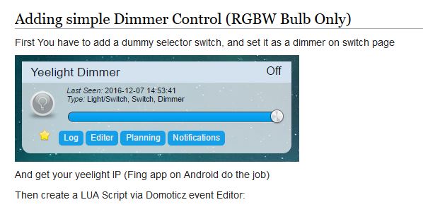

I made a mistake, this script is meant for a virtual dimmer switch, the wiki page says:
The script is working however,
When I turn the virtual dimmer switch on, I want it to set to an initial dimmer value of 5%
By the way I turn the virtual dimmer switch on with an KAKU remote and the remote learned on/off switch (with voice)

Re: Set initial brightness level of Yeelight RGBWW bulb
gschmidt wrote: Saturday 28 March 2020 9:58 In the virtual dimmer script I have, “Tafel Lamp” is the virtual dimmer, there is a line: if (device.state == ‘Off’) then
If I place there device.dimTo(5), then the light first is set to off but then it turns on again to dimlevel 5%
Where should I place this then?
If you use device.state then you check the state of the virtual dimmer. What I meant was to check the state of the Yeelight bulb itself assuming you have them configured in domoticz as a separate device.
