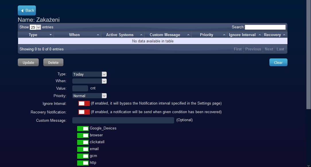

Tell me how to set a notification to Telegram
If the number of infected increases by at least 1 then send a message
I have set:
Last update
Greater
Value (I don't know what to insert here)
Errors only in logs.
What script is this supposed to be? lua, python, dzVents?
Is the script to be added in Events?
Which sensor should I choose exactly?
Counter / Counter?
Do I need to add anything to the sensor settings?
P.S.
Everything is working now
I have set:
Last update
Greater

try this one (adapt your settings to your needs)kniazio wrote: Sunday 22 March 2020 22:00 Tell me how to set a notification to Telegram
I have set: Last update Greater Value (I don't know what to insert here)

What should I enter in the Value field?elmortero wrote: Wednesday 25 March 2020 13:49try this one (adapt your settings to your needs)kniazio wrote: Sunday 22 March 2020 22:00 Tell me how to set a notification to Telegram
I have set: Last update Greater Value (I don't know what to insert here)Code: Select all

- telegram.jpg (77.23 KiB) Viewed 2880 times
