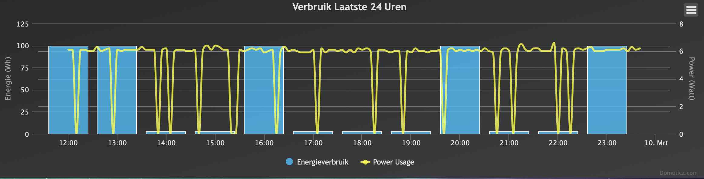

I have installed a Qubino 3-phase Smart meter (ZMNHXDx).
It is linked via aeotec Z-wave stick to a RPI (OpenZwave) running the latest stable version of Domoticz (4.10717)
The Qubino is being polled every 60 seconds.
The 3-phases all feed into an EV Charging point.
When there's no car charging the charging point is still using around 6 Watt.
I have to questions (see graph):
1) How can it be explained I get 'zero' readings (instead of the 6 Watt) once every hour or so?
2) Why does Domoticz report a 100 Wh energy usage a view times a day (while there is nothing charging).
Is this Domoticz misinterpreting Qubino data?
Is it a Qubino misreading?
Has it something todo with polling?
Hope someone had solved/explained this problem...
Thank you very much!
Best, Arjan444

Hello
Turned out I was looking at the kVAh value that ended up in the KWh meter field.
That explained the slightly higher values.
I did some more research and testing.
I also upgraded Domoticz to the latest beta (4.11786)
That made the problem even more interesting because now there are 6 values written to the same field with the name ‘kWh meter’.
These 6 values all cary the label 'Total Readings Electric’.
Only the last one (this time it is 'kVarh') ends up in Domoticz.
All other 5 values are there for a split second before they are overwritten.
The first one of the 6 'Total Readings Electric’ is the actual kWh value.
That’s the one that should end up (and stay) in the kWh meter field.
I only need the kWh value.
Am not sure if this is a Openzwave of Domoticz problem.
Can I somehow change a config file or a script to stop reading the other values?
Or is there another way to get the right kWh value on the Domoticz dashboard?
Hope someone can help.
Thanks. Arjan444
