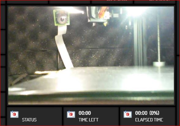

nice work on the camera plugin i also try'd days to get the popup screen to work with iframe scaling but it was a pain and never workt the way i wanted it.
i only have a small problem (not a big one for me) but the focussed icons from dashtics are seeing true the popup when i click my camera picture.
i apply'd the latest beta but i cant figure it out.
here is an example:
any ideas?

It sounds as if your icons have a high z-index. Try adding this to your custom.css file.
.cam-container .stream {
    z-index: 10000;
