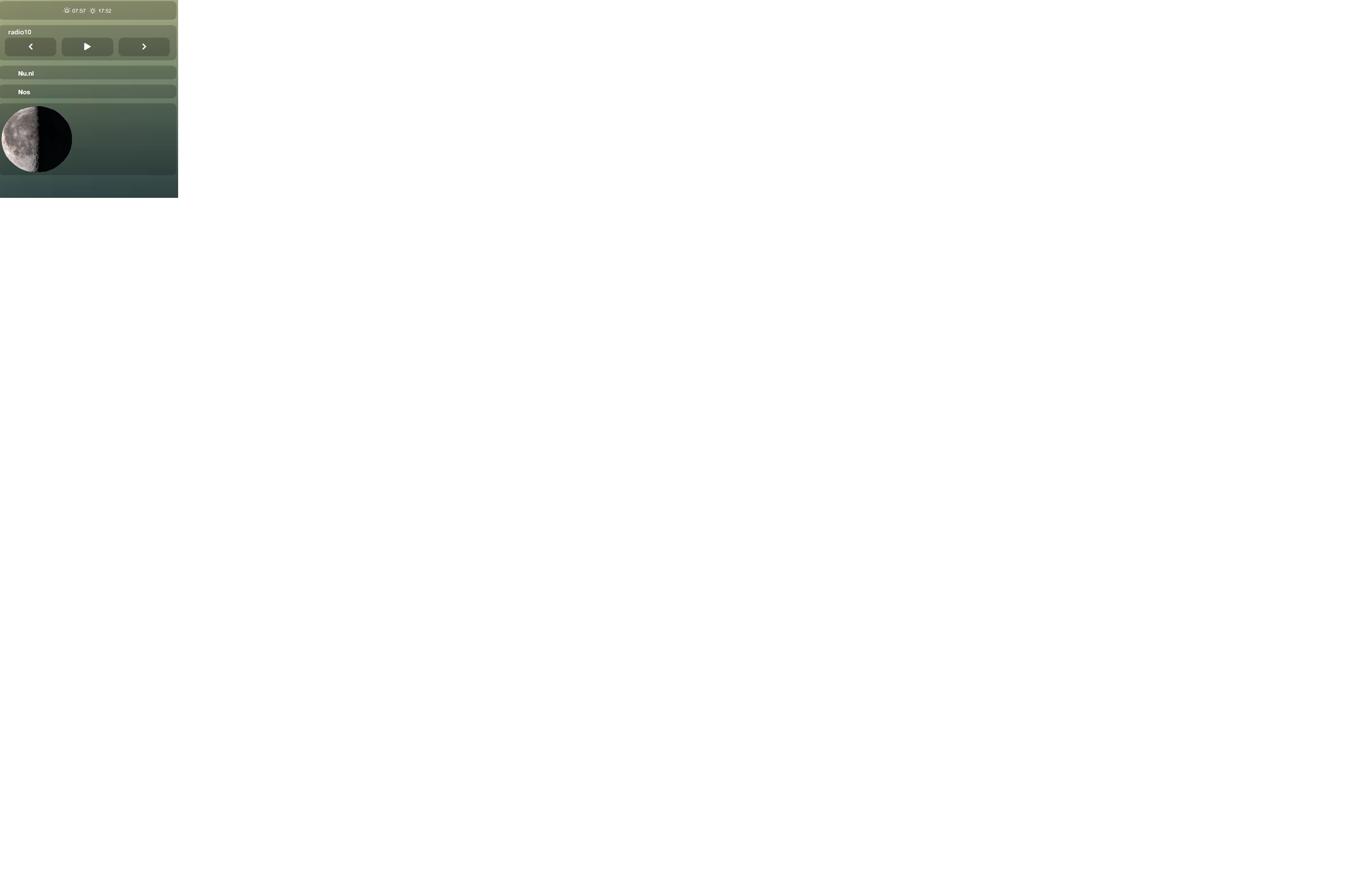

how can i center the moon picture in the block?

If you add key: 'moon' to your moon block, you can apply css to it in your custom.css.
buttons.moon = {
  key: 'moon',
  width:12,
  isimage:true,
  refreshimage:60000,
  image: 'moon'
I haven't tried is, as I don't use the moon block. But you may start with trying this:
[data-id='moon'] {
  text-align: center;

Great thanks, its working.
