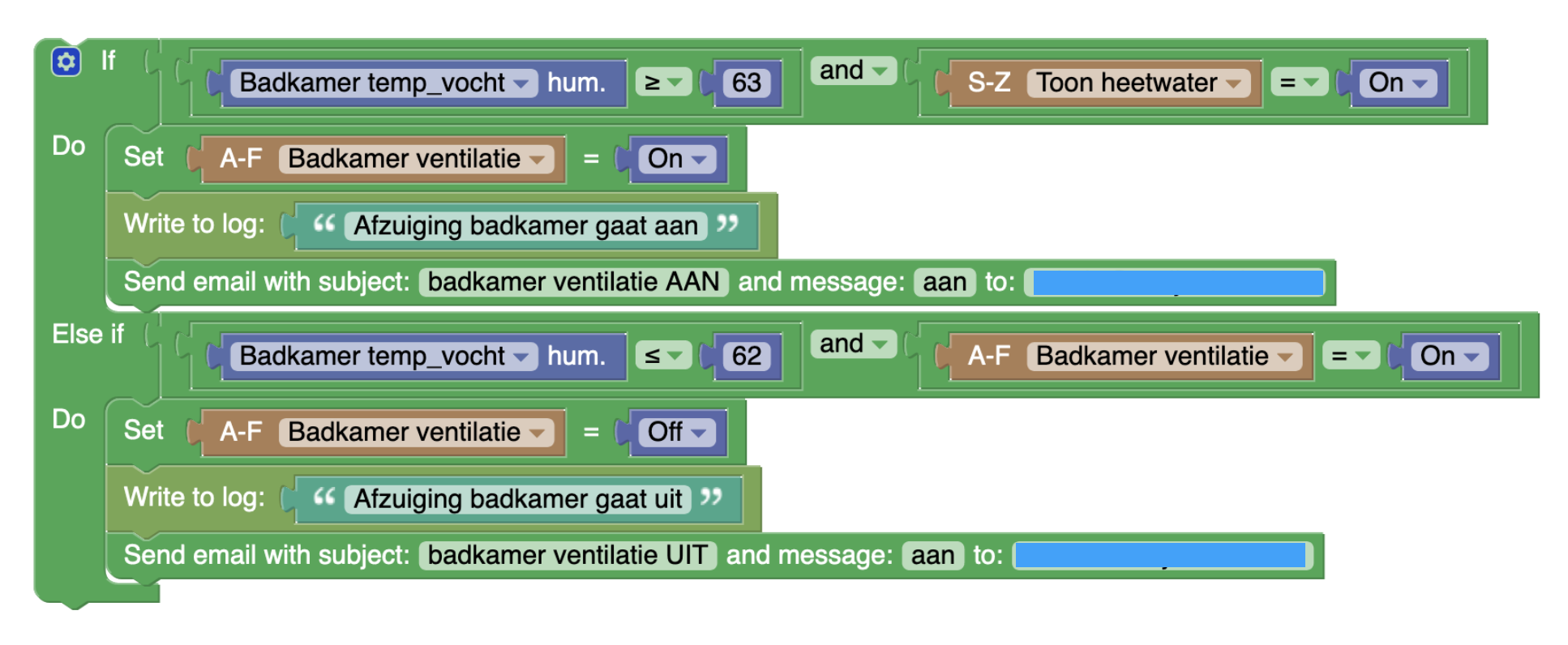

I have made a blocky for my bathroom venting, it works! But it only is looping.
When the switch is on, it give's every minute an ON signal.
Is there a way to prevent this?
 2020-02-02 11:12:46.907 Error: (Zigate) Command: 0x0092:On/Off failed on relay afzuiging badkamer
2020-02-02 11:12:46.907 Error: (Zigate) - Device: Badkamer ventilatie NwkID: 25dd IEEE: 00158d0003f05121
2020-02-02 11:12:46.907 Error: (Zigate) - Code: d4 Status: Unicast frame does not have a route available but it is buffered for automatic resend
2020-02-02 11:13:32.307 Error: (Zigate) Command: 0x0092:On/Off failed on relay afzuiging badkamer
Schermafbeelding 2020-02-02 om 12.14.01.png (347.48 KiB) Viewed 468 times

I would suggest to check first if "Badkamer Ventilatie" is already on after your humidity check.
If so don't do anything, if not switch it on
Peer

peerkersezuuker wrote: Sunday 02 February 2020 13:23 Hello,
Peer
Thanks for helping. But how to "If so don't do anything" ?
Mark
mrf68
Re: Bathroom venting Blocky
Post by mrf68 »
Add to the first IF statement: AND badkamer ventilatie = Off
