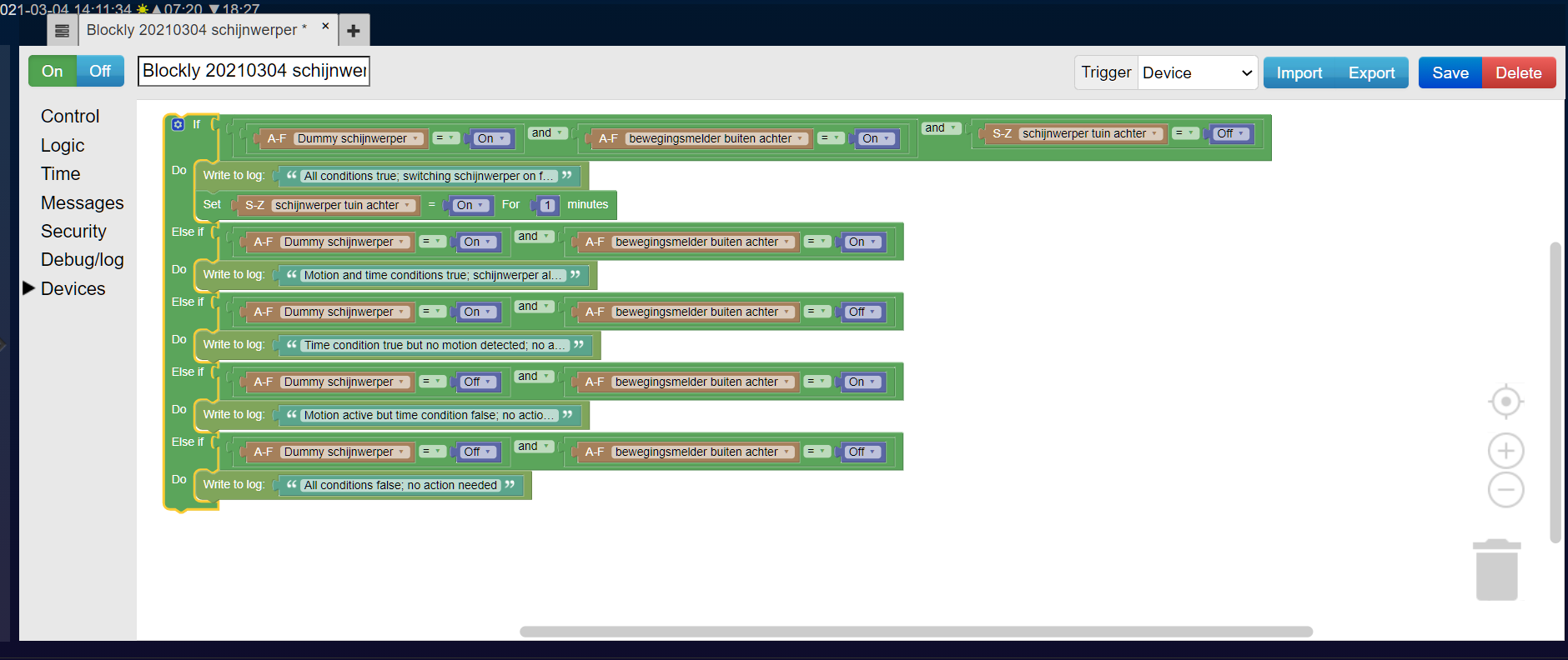

rolandtwilt wrote: Thursday 04 March 2021 13:36 I understand what you mean and I have adjusted this. but unfortunately the script still doesn't work
Can you try this one (import code block in event editor and change device ID's to names)

thanks i'm going to try

It functions! sometimes with quite a bit of delay, but it works. thanks!

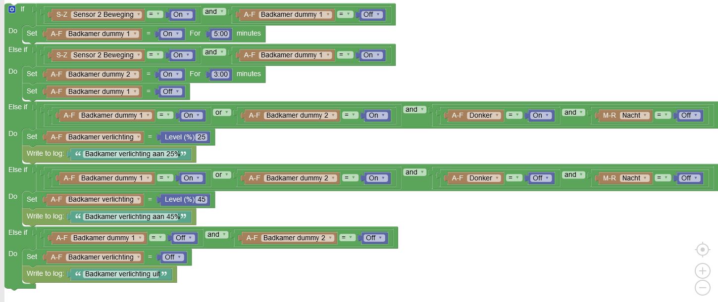

This worked for me:
The "Nacht" (night) function was added just to turn the light on only during the day.
The "Sensor 2 beweging" is a Fibaro sensor which has to turn on the light on movement.
The code, you can import this in Blocky:

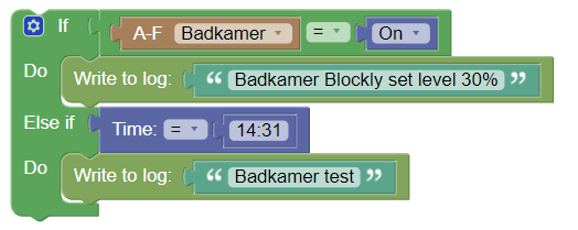

I think te the problem could be the first time comparison “20:00 and 8:00” this passed midnight ’00:00’.

Treve wrote: Thursday 09 December 2021 14:22 I think te the problem could be the first time comparison “20:00 and 8:00” this passed midnight ’00:00’.

The use in one ‘if-then’ of two same “badkamer” cause the problem.
If badkamer is on, then set badkamer 30% and switch badkamer to something else because is not on anymore.

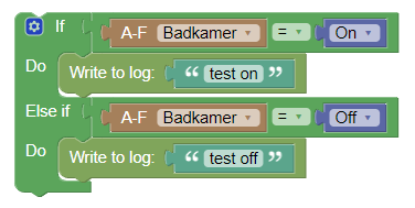

Somehow this only returns logging on the off switch.
Even though the switch is set:
2021-12-09 14:53:25.480 Status: User: Admin (IP: 10.0.0.32) initiated a switch command (211/Badkamer/Off)
2021-12-09 14:53:28.792 Status: User: Admin (IP: 10.0.0.32) initiated a switch command (211/Badkamer/On)
2021-12-09 14:53:34.267 Status: User: Admin (IP: 10.0.0.32) initiated a switch command (211/Badkamer/Off)
2021-12-09 14:54:09.548 Status: User: Admin (IP: 10.0.0.32) initiated a switch command (211/Badkamer/On)
2021-12-09 14:54:12.455 Status: User: Admin (IP: 10.0.0.32) initiated a switch command (211/Badkamer/Off)
2021-12-09 14:56:17.426 Status: User: Admin (IP: 10.0.0.32) initiated a switch command (211/Badkamer/On)
Same if i do it the other way around.
Somehow the "on" command doesnt trigger anything.

I shouldn't be answering this here, as this thread is meant to post examples, not discuss problems with one that doesn't work for you. So if you could move this discussion into a new thread that would be very welcome.
I don't know what exactly causes the behavior you're seeing, or how to fix it. But I do know that you are creating an endless loop here: For a dimmer everything above 0 is considered "On", so once you switch the badkamer light to anything but "Off", you're having Domoticz set the level to 30%, which is a command to switch the badkamer "On", which triggers your script, which ....
So I don't think this is the way to achieve what you want. Others have tried the same thing before and I don't think I've seen a solution that actually works, other than having two separate devices -one being a switch and the other the dimmer- then only have the switch controlled by the 'user' and have a script trigger control the dimmer based on the switches state. The problem is that once your script gets the trigger for the "On" state change, the light is already on; at whatever percentage the dimmer starts (usually the last brightness it was set to). The dimmer doesn't have separate level and state attirbutes, they both control the same property of the dimmer. This the nature of how z-wave dimmers are implemented. The only way I know to avoid that problem is to have a separate switch and you can set the dimmer to whichever level you like when the switch gets toggled like i described above.

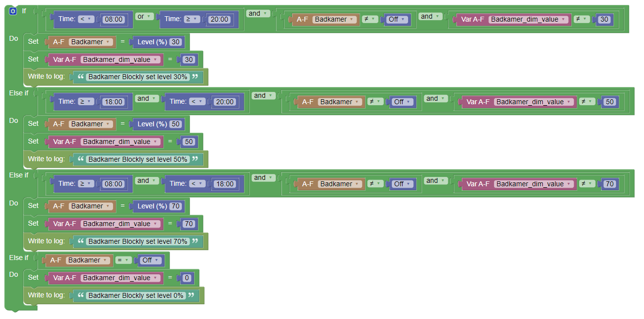

It's working!

Treve wrote: Saturday 11 December 2021 16:18
MikeyMan wrote:It's working!
What is the function of the Variable?
Making sure it won't continuously trigger.
Allows to use the wall switch to dim.

Ok, I didn’t noticed the unequal sign.

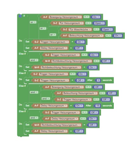

This is a Blockly i'm using for my lights.
You need two Dummy Switches: "Trigger" and "Delay".
In this case there is one Motion Sensor ("Bewegung"), two Door Contact ("Tür"), one bright light ("Beleuchtung") and one low light "Richtbeleuchtung".
The light ist switching on if a door is open or motion is detected, and stays on until no motion is detected and the delay is over.
It only send a Z-Wave Signal once to switch on the low light, to keep the network traffic low.
