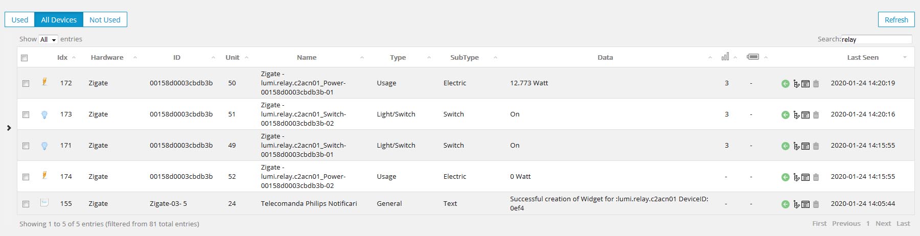

Yes you're right, it's working now. In domoticz were created 2 switches and 2 power usage widgets, but only 1 power usage widget(ch1) is working and show live power for both switches.
This function is avaible only on the beta branch?
Thank you!

Correctn only available on beta branche, I'll update in order to have the Meter/POwer created only on the first channelpfloryann wrote: Friday 24 January 2020 13:28 Yes you're right, it's working now. In domoticz were created 2 switches and 2 power usage widgets, but only 1 power usage widget(ch1) is working and show live power for both switches.
