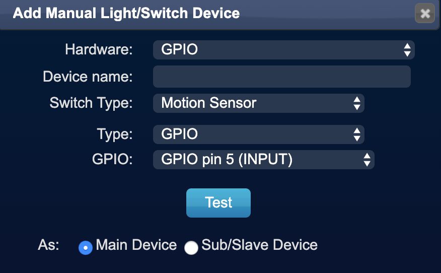

I'am new to Domoticz. Just installed it (v4.10717) on Raspberry Pi 4B and configured basic settings. Everything looks OK but I wanted to integrate Domoticz with my Satel alarm system using direct GPIO connection. At the beginning I wanted to obtain info from one of my motion sensors. I used pin no. 29 and the ground on Raspberry Pi to connect it to Satel's output. I also installed Wiring Pi (v2.52), exported GPIO as input and set edge to falling.
In Domoticz I added new hardware:
and new switch:
Now Wiring Pi shows GPIO's status changes correctly when the motion sensor detects motion but Domoticz does not. Sometimes when I restart Domoticz the status is changing for a while and then stuck. I tried on Chrome and Safari.
Can anyone tell what I'm doing wrong?
