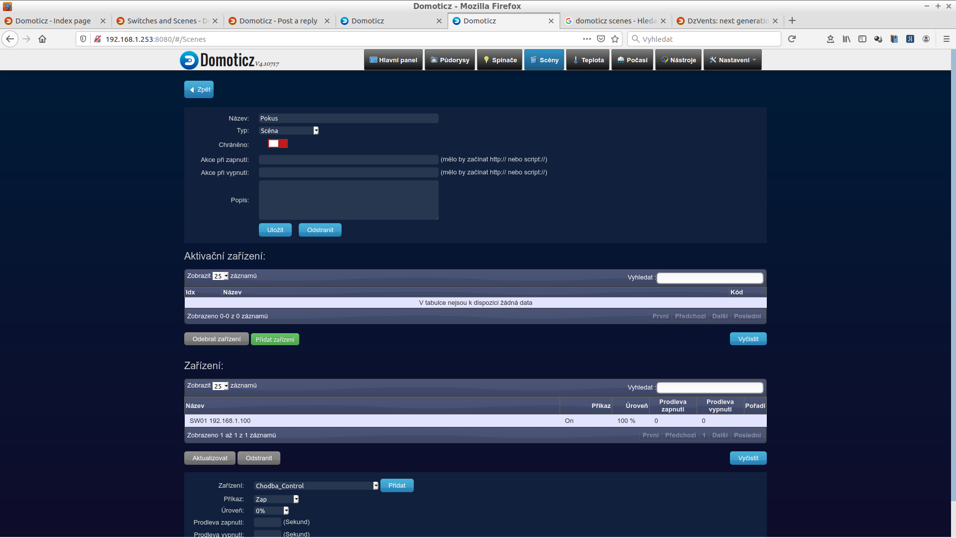

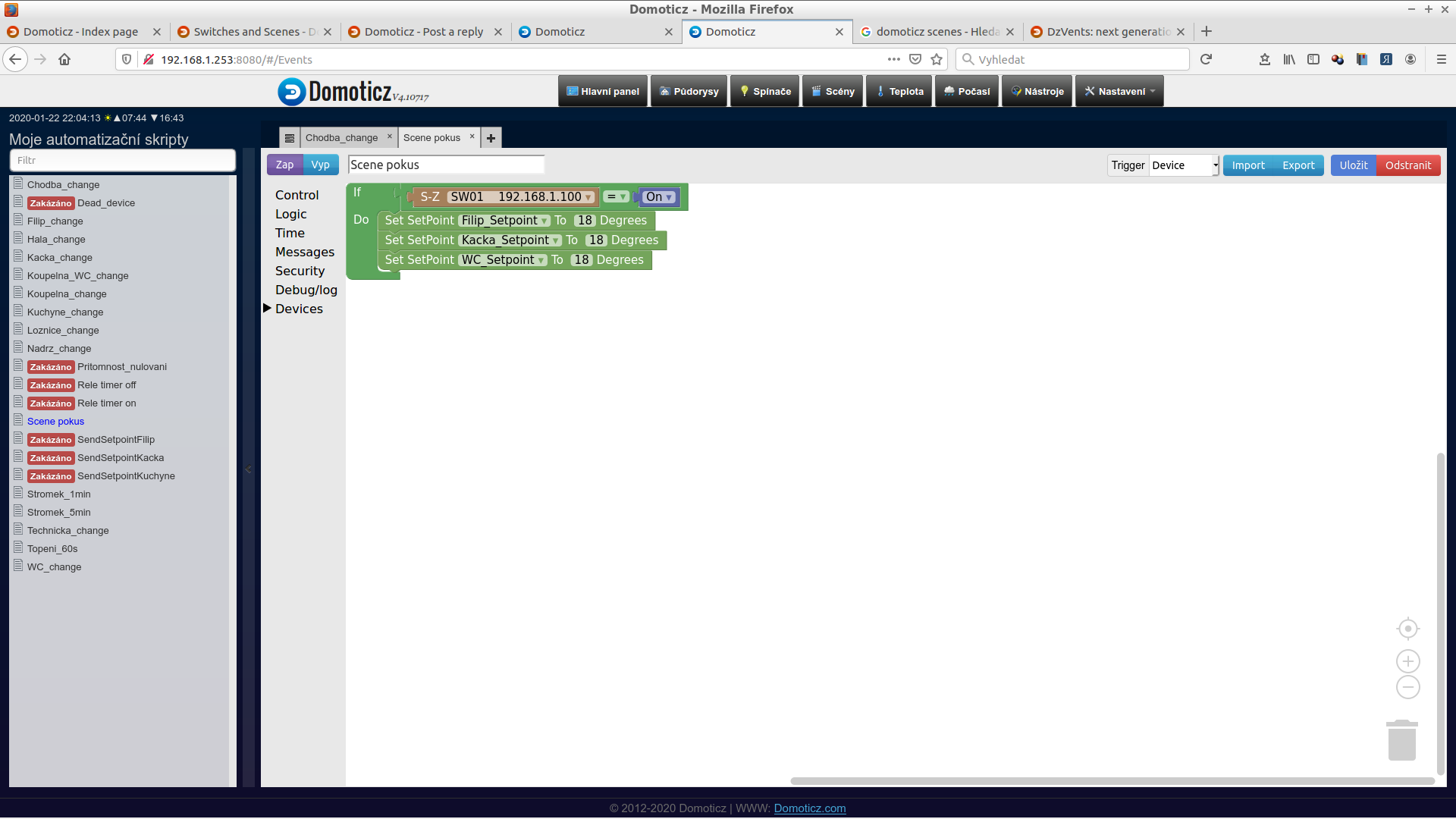

You can use DZVents script with scene trigger.
Or, if you are not familiar with DzVents scripting you can use Blockly with a little workaround.
Create your scene and use some dummy switch witch will be set ON in this scene.
Then in Blockly, when this switch is activated, set your setpoints to required value.
In other scenes set this switch OFF
I tested it - it works
