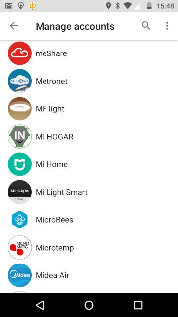

I do not own a MiLight, so I cannot confirm it, but if you open your Google Home app and you go to "Manage accounts" you will find this:
Clicking Mi Home asks you to sign in with your Mi Account (Xiaomi), while Mi Light Smart points to Tuya.
But maybe Arie can confirm?
