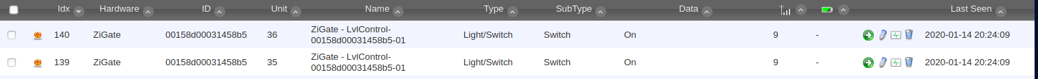

I have bought a Paulmann LED dimmer https://en.paulmann.com/indoor-lighting ... w-ac/50044
It connects but Domoticz creates 2 exactly the same devices in the devicelist. I am on latest stable Zigate plugin and latest firmware (but just updated before this action). Domoticz v4.11070
Screenshot_2020-01-14 Thuis.png (30.38 KiB) Viewed 456 times
Log file while creating:

plugin devices json
NwkId : "3057"
Stamp : Object {"Time":"2020-01-14 20:19:10","MsgType":"8102","LastSeen":"14/01/2020 20:18:58"}
Health : "Live"
Status : "inDB"
Battery : ""
RSSI : 177
Model : ""
IEEE : "00158d00031458b5"
ProfileID : "0104"
ZDeviceID : "0101"
DeviceType : "FFD"
LogicalType : "Router"
PowerSource : "Main"
App Version : "1"
Stack Version : "1"
HW Version : "1"
LastSeen : "14/01/2020 20:18:58"
Ep : Array[1] [{"Ep":"01","ClusterList":[{"0006":"On/Off"},{"0000":"Basic"},{"0004":"Groups"},{"0003":"Identify"},{"0008":"Level Control"},{"0005":"Scenes"},{"1000":"Touchlink"},{"0019":"Over-the-Air Upgrade"}]}]
WidgetList : Array[2] [{"_WidgetID":"139","WidgetName":"ZiGate - LvlControl-00158d00031458b5-01","WidgetType":"LvlControl"},{"_WidgetID":"140","WidgetName":"ZiGate - LvlControl-00158d00031458b5-01","WidgetType":"LvlControl"}]
LastCmds : Array[5] [{"CmdCode":"0120","TimeStamps":"14/01/2020 20:19:10"},{"CmdCode":"0100","TimeStamps":"14/01/2020 20:19:10"},{"CmdCode":"0100","TimeStamps":"14/01/2020 20:19:10"},{"CmdCode":"0100","TimeStamps":"14/01/2020 20:19:10"},{"CmdCode":"0100","TimeStamps":"14/01/2020 20:19:10"}]

This looks indeed strange.
Can you attached the file Data/DeviceList-xx.txt ?
Posts: 7009
Domoticz version: 2026.3
Re: Zigate with Paulmann 500.44 dimmer creates 2 devices
Devicelist added as attachment
DeviceList-8.txt
(33.07 KiB) Downloaded 72 times
pipiche
Posts: 2035
Post by pipiche »
Thanks for the information.
I have no clue why the plugin did it.
You can remove one of the 2, it shouldn't impact the behaviour.
