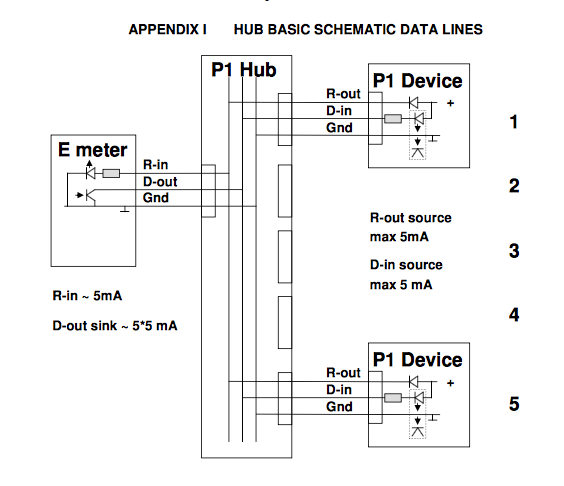

So your problem is you want the right values from your p1 smart meter also in domoticz?
can't you use another p1 smart meter cable connected directly to domoticz, and put that cable in parallel with the p1 cable you already use ?

Using another p1 smart meter cable won't be necesary, since both Domonticz and Web Solar Log are running on the same machine. The problem is however, that (I understood that) the smart meter will output all zero's for the data, if it is polled more then once within 10 seconds. I can adjust the polling rate in WSL, but don't know how to do that in Domoticz.
Either way, one will be "overtaking" the other at some point, so it's best to only have one system poll the meter physically and let the other system query for the gathered data.

According to the P1 Protocol specifications you can use a 2 P1 cables in parallel. Just go to your local hardware store and buy a telephone splitter, order an P1 SmartMeter cable and small USB hub.
As Gizmocuz suggested, the best option without adding additional hardware is to send data from WSL to a Domoticz Virtual Sensor using JSON (or the other way around of course)
- P1 Splitter
- Screen Shot 2014-08-09 at 11.50.35.png (47.38 KiB) Viewed 9935 times

Thanks for the scheme.

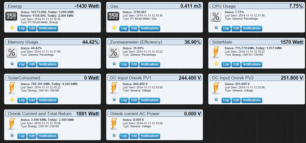

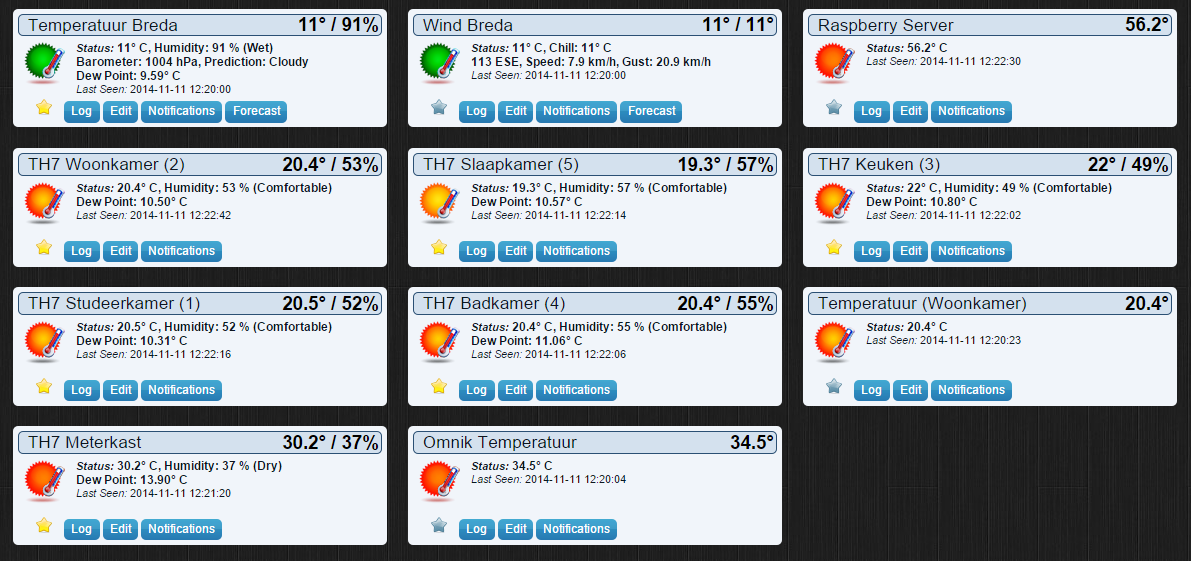

- Omnik Script.png (141.71 KiB) Viewed 9793 times
- Omnik a
- Omnik-Domoticz2.PNG (151.53 KiB) Viewed 9793 times
- Omnik-Domoticz.PNG (143.76 KiB) Viewed 9793 times
