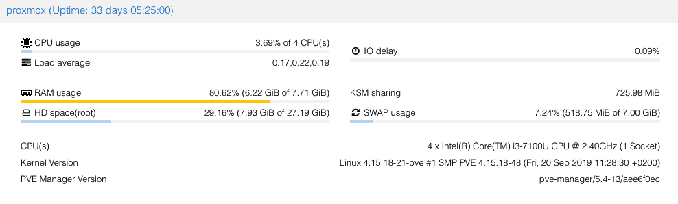

I have a Intel Baby Canyon NUC7i3BNH with 8GB RAM and a cheap Kingston SSD of 120GB.
I run Proxmox on it as a hypervisor, so Domoticz runs in a virtualized KVM container on Debian 10.
I also added a second USB network card. Thanks to that I can also run pfSense on the same NUC. pfSense is an advanced firewall. In pfSense I can block access to my domoticz from all countries other than my own. That blocks several hundreds of access attempts every day.
Because I use a hypervisor I didn't spent much on the SSD as I can easily make backups to the nas.
If the SSD crashes I only have to reïnstall Proxmox and restore the images.
If also the NUC dies completely it's the same story without having to worry about hardware compatibility.

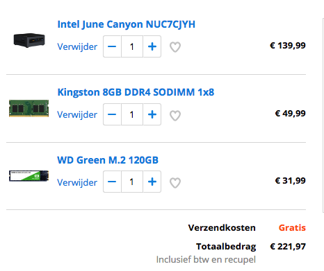

I looked around this afternoon, and finding out "just a NUC" is not something you just do .....
In the meantime, I understand that with every NUC you have to order both memory and a disk,
But which NUC is "Good", (@ben53252642) called an i3 minimal, but then ...
For an SSD you can again choose from a large list of different disks ....
Not to mention memory.
In any case, I do not think that you have a complete NUC for less than € 300, do not yet know whether I think it is worth it ....
For the sake of clarity, I am a hobbyist who likes to be able to automate things at home, but certainly not a computer expert.
I think I will first build the new Pi4, possibly later with an external SSD disk and maybe something will come my way ...
Sorry for the effort you put into it ....

Na, an i3 is not minimal, it's a huge amount of speed for a Domoticz / home automation system, I've run > 10 virtual machines on one.
I like the i3 because it's low power consumption and doesn't generate a lot of heat.

I think any Nuc will be faster and more reliable.
They don't need to cost more than € 300:

Thank you for helping me choose, I now have the above set, but then 240 instead of 120 GB, for around € 200!Egregius wrote: Saturday 28 December 2019 7:46 I think any Nuc will be faster and more reliable.
If all goes well, it will be Monday here.
